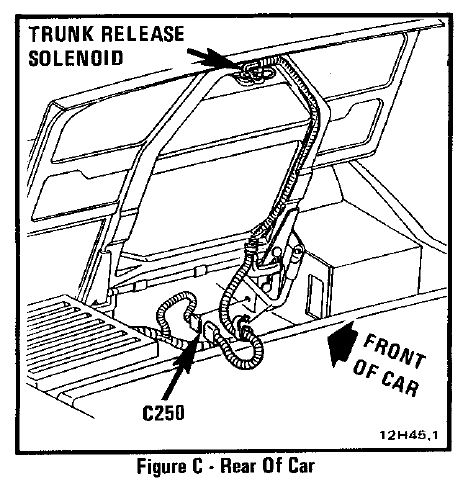

Hi All, If anyone can let me know what is not connected to the 4 prong plug inside the engine compartment on the battery side, shown in the attached photo, I would really appreciate it. Thank you. reb

Decklid release harness and I believe trunk ajar light. [This message has been edited by IMSA GT (edited 11-06-2023).]
NOV 06, 08:41 PM
I'm not 100% sure of this, but doesn't the harness in the decklid for the electric lock plug into that?
[EDIT] We posted at the same time. You confirmed what I thought about the lock... but where's the light in the decklid? I'm only familiar with the light in the trunk.
[EDIT 2] Okay, you changed your post... the decklid/trunk ajar light switch.[This message has been edited by Patrick (edited 11-06-2023).]

Yes, deck lid wires. Can see other side hanging in same pic.
3 pin for ajar, light, ground 1 pin for powering the release solenoid if has this option. Ground thru latch & strike loop.
⚠️ Unplug & "new car" often mean ajar switch of latch had problems. Common issue "ear" that hits the loop wears & don't work & keep ajar &or truck light On.
If true, the "ear" is pollyprop & glue will not stick. Need more PP "rod" & melt together. Used PP can be used but must be cleaned so no food or grease on it.
⚠️ Soldering tools can easily burn the plastic causing problems. If can adjust temp very low, do so.------------------ Dr. Ian Malcolm: Yeah, but your scientists were so preoccupied with whether or not they could, they didn't stop to think if they should. (Jurassic Park)
| quote | Originally posted by rebeck02:
I appreciate all of you responses and help, as well as the details from Ogre. Have a great day! reb (Roger) |
New ajar switch. When it's bad, it can blow the fuse. https://www.fierostore.com/...ail.aspx?p=1&s=64646
