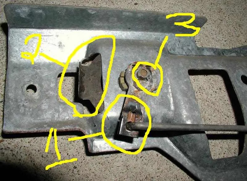

If I turn my key in the door lock and there is no resistance in either direction (and locked door doesn't open), is it most likely the cylinder that needs to be replaced?
Thanks
sleek fiero
NOV 26, 11:47 AM
Maybe one of the plastic actuator rod clips broke and the rod fell out of place . the tumblers must be ok if you can put the key in and turn it. sleek
IMSA GT
NOV 26, 02:50 PM
Sounds like one of the retainers has fallen off and the rod fell out. You can buy the retainers from Dorman or used from Ebay.
This is from another thread and the person marked this up This is a photo of the back of the door lock cylinder. Either #1 or #3 fell off

The rod may have also fell off the latch part as well if the clip broke (or is missing).
NOV 28, 08:26 AM
for new rod clips... try dormanproducts.com once you find a PN order thru most part stores, amazon, etc.------------------ Dr. Ian Malcolm: Yeah, but your scientists were so preoccupied with whether or not they could, they didn't stop to think if they should. (Jurassic Park)
