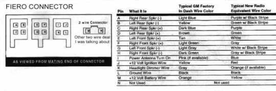

I'm returning my fiero to the stock radio and had some questions about wiring. The car previously had a pioneer deck installed by me sometime around 2000. Sadly the original harness was cut, thankfully I have a replacement Metra stock harness I'm in the midst of putting in. I just wanted to clarify some wiring colors after spending time searching the forum.
Fiero Speakers
RR + DK Blue RR - LTBlue
LR + Brown LR – Yellow
LF + Tan LF – LT gray
RF + LTGrn RF – DrkGRN
12V Constant ORANGE 12V Switched ? Ground Black
Remaining unknown wires
2 Pink wires 1 yellow and black 1 gray and black
It appears as though the installer pulled a switched 12V wire right from the fuse block, but I'm not keen on this if I can avoid it.
I'm going to put a modern bluetooth stereo in , but want to start with a stock harness and make a proper adapter - Hence the desire to return it to stock. Thanks!
JM
1985 Fiero GT
DEC 02, 09:24 AM
This is a graphic I found to help me do the same thing that you are doing
It is accurate, at least everything works on my 90s Pontiac radio!
