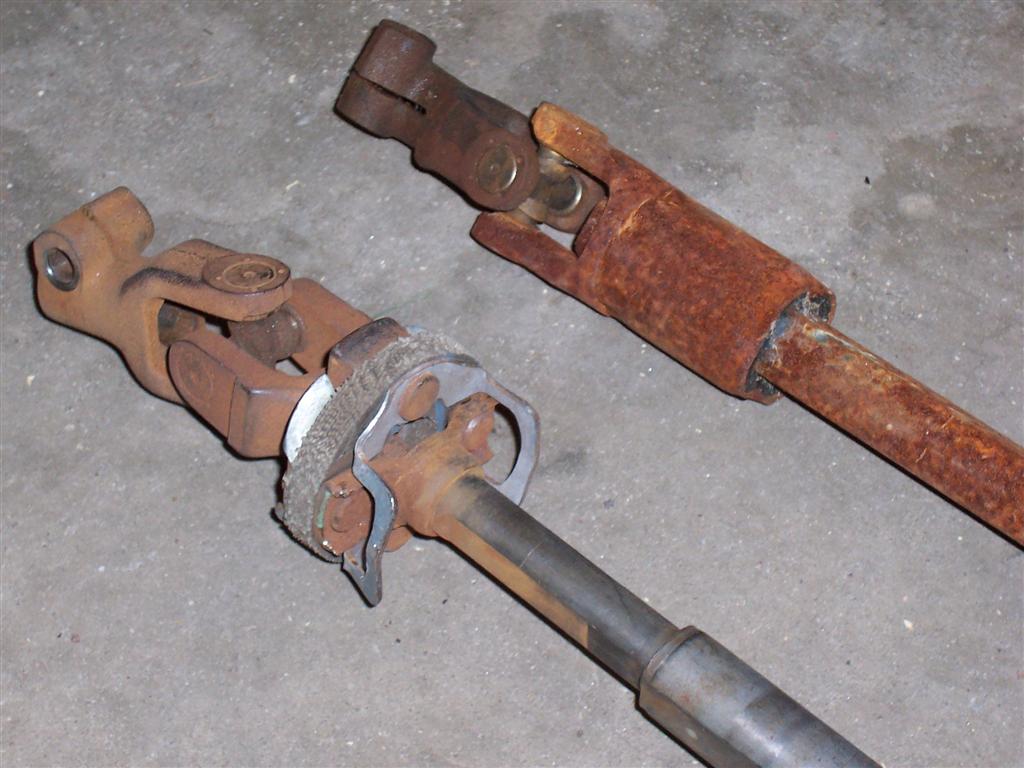

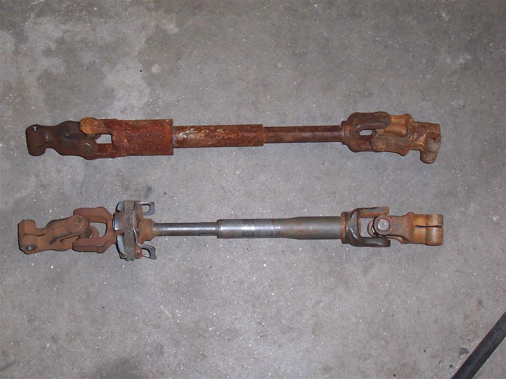

fierogt28
JAN 11, 09:47 PM
As for the rag-joint difference, I had photos from years ago from a members post.
You can see clearly the 2 design differences.
Hope this helps...------------------ fierogt28
88 GT, Loaded, 5-speed. 88 GT, 5-speed. Beechwood interior, All original.
phils88GT
JAN 11, 10:01 PM
Thank you for the pics. I haven’t had time to check her out, and when I do, the weather is crappy. Is the best way to get eyes on this to pull the tub in the front?
