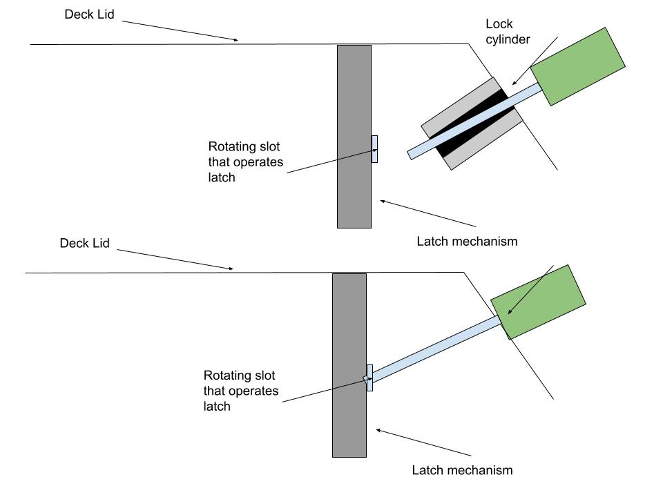

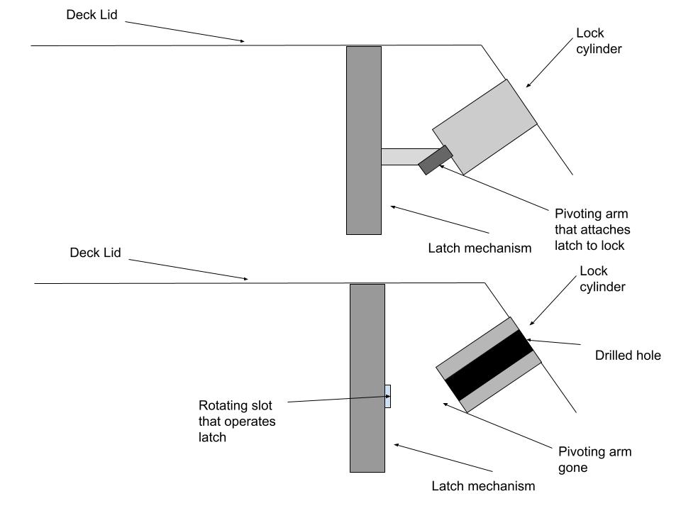

here is a very crude diagram that shows a side veiw of the lock and the latch mechanism. If you were like me you would have ended up drilling all the way through the lock which causes the arm that attaches the lock and latch together (dont know what its called) to fall and will no longer be attached the the lock, preventing you from be8ing able to open the trunk despite the lock being able to spin freely with a screw driver.
the next best thing is to access the rotating slot that operates the latch mechansm with a flat head screw driver. but with just a small hole int the lock, theres no way to access the slot due to the angle. What i did to fix this issue was to surgically remove the lock cylinder in order to access the slot on the mechanism. How I acheived this was by takinbg a big chistle and hammer and beating the living crap out of the lock cylinder until it inevitablly disintagrates into small enough pieces in which it can be removed through the key hole. I was then able to access the hole in the mechanism on the latch with a screw driver,
hope this helps for anyone else having an issue!------------------ James Bird
