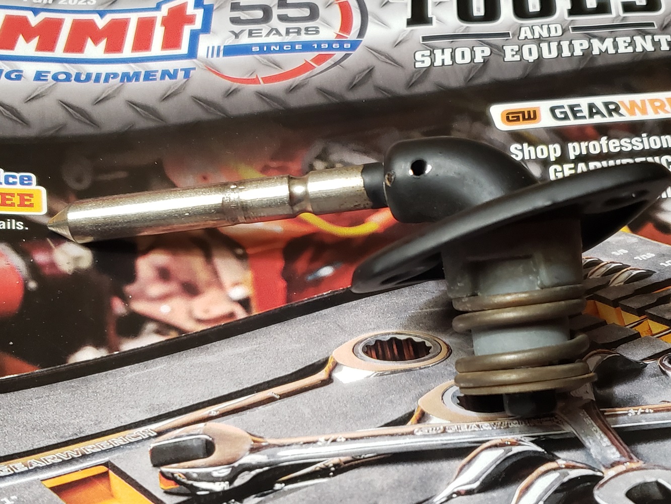

My visors would never stay up or tighten no matter what. Turns out there is a roll pin in the dowel the visor clamps onto. Mine had fallen out at some point so the dowel would just spin freely. My head light motor gear did this too a while back. Good as new now.
