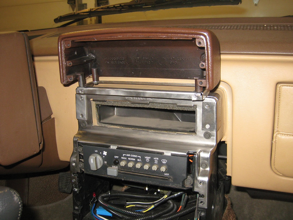

I installed (aftermarket) gauges in the rally gauge pod on my 1985 Fiero.
This is how I brought the wiring from the gauges to the area behind the radio.
General view:

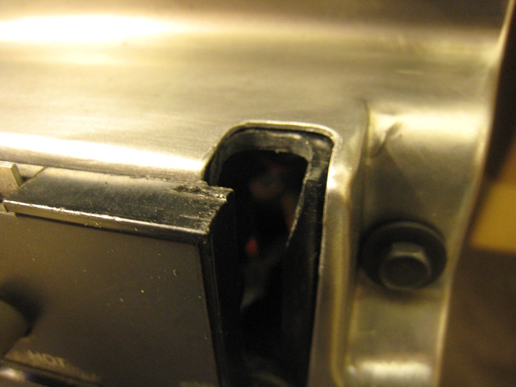

I cut a notch in the steel support piece and in the plastic skeleton:

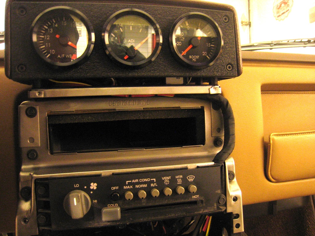

Wiring is routed behind the HVAC control, with wires wrapped in tape to protect the tires from chafing:
