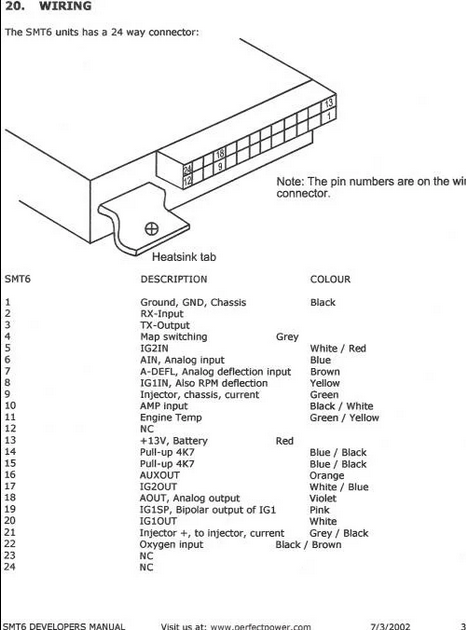

I don't know if this is any help but here is the pinout and wire colors for their SMT-6 unit. I don't know if it's the same.
Holy smokes! It looks like the same connector. I'll have to check wire colors to verify, but it sure looks like it. As I understand it the SMT6 is similar, but used USB programming.
