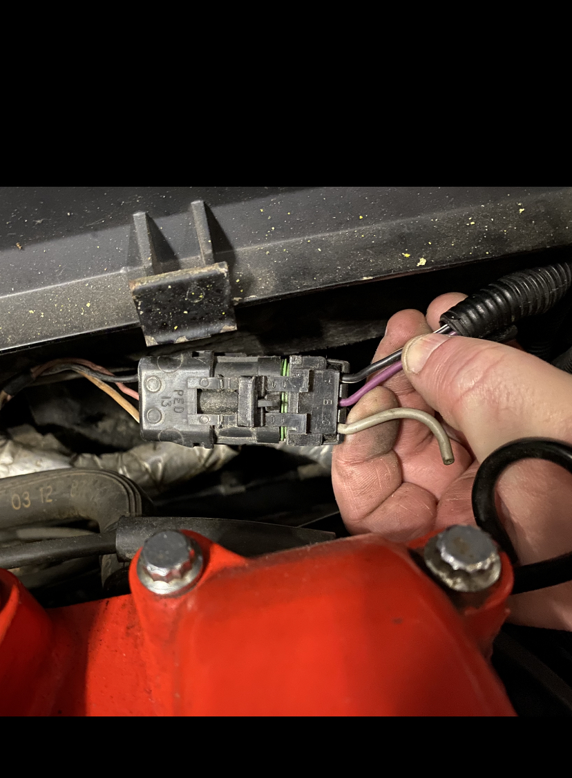

So the best I can tell, it seems this modification has been made to the fuel pump wiring. It looks like the oil pressure sending unit has been taken out of the loop. Would they make the fuel pump run with the key in the on position?
http://www.gmtuners.com/fiero/hot_wire.htm Here is a pic of the connector that goes down to the fuel tank:

I don't have the schematic for your engine/year readily available but from what you described and what is on the gm tuners site, yes it looks like the oil pressure switch has been taken out of the circuit. I don't know about you but having a fuel pump that stays on continuously without the engine running is not something I would be comfortable with. The switch is pretty simple in function the contacts close when it's got good pressure. If I recall correctly it's pretty low maybe 5-10 psi.

Yeah I’m not comfortable with the fuel pump running constantly hence why I’m trying to get this issue diagnosed and fixed to work as designed. A couple of developments….I have confirmed that the oil pressure switch has been removed from the circuit. With that being said, will this alone cause the fuel pump to run with the key in the on position? Another item is my fuel gauge reading as always empty. I unhooked the C502 connector at the firewall and the gauge we’ll all the way to full. I ohmed out the power and ground wires for the sending unit going to the tank and they are grounded together. So it seems there is an issue bt the connector and the sending unit in the fuel tank. So I’m going to drop the tank and take a look at the wiring to the fuel pump and sending unit and verify/fix any wiring issues.
