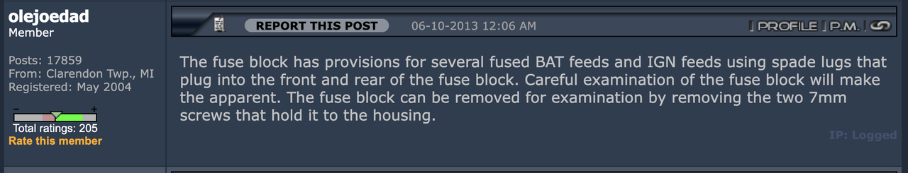

And as described by olejoedad in this thread: https://www.fiero.nl/forum/...160323-2-128864.html

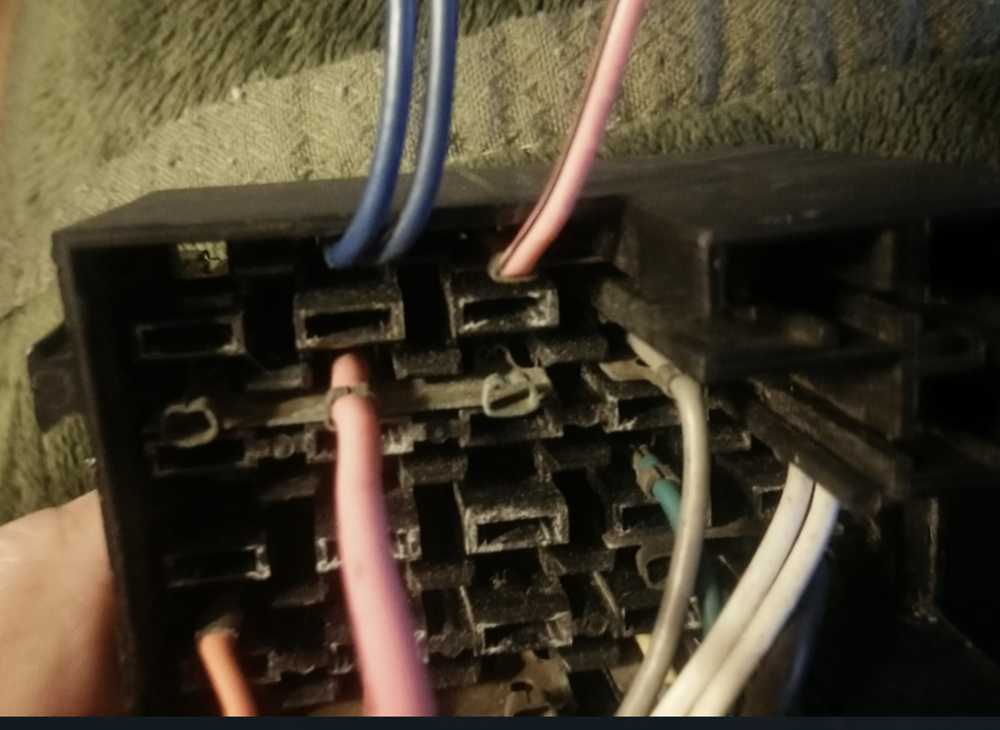

i have this old fuse box (i think for a Fiero, but dunno really)
Is this one of those unused power feeds - notice the three linked hots but only two on the other sides of the fuse. How do i insert another wire on the other side of the fuse?
