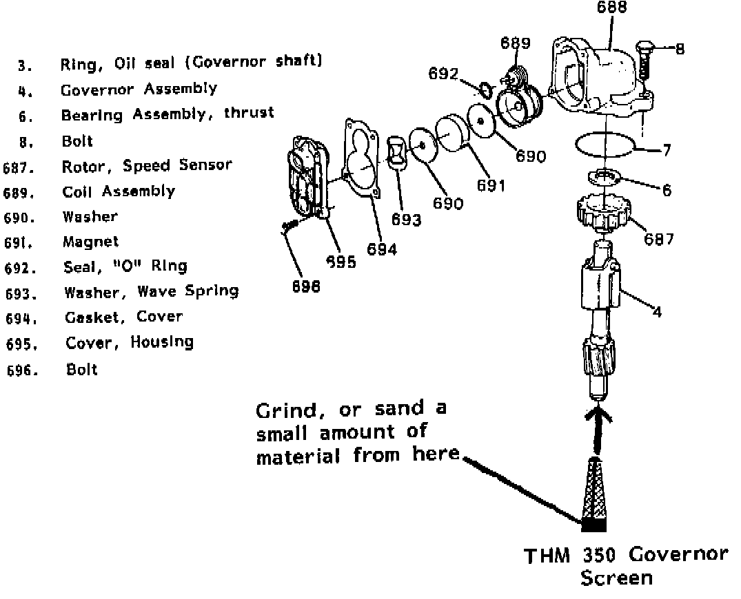

Late or no up shift is often a Governor problem can be dirt block flow in/thru it or other problems. Governor shaft drive the VSS too but that is only for Speedo, cruise & ECM use have nothing for shifting. Messing w/ the governor & doing wrong is a tow to trans shop & hope they still have parts for TH125c/3T40.
Do you think there's any benefit in removing just the governor cover to look inside for anything obvious, or is that just asking for trouble? I am in agreeance that I don't really want to mess with it directly if I can help it.

| quote | Originally posted by Island198: Do you think there's any benefit in removing just the governor cover to look inside for anything obvious, or is that just asking for trouble? I am in agreeance that I don't really want to mess with it directly if I can help it. |
Very likely looking @ it won't help.
Example: If dirt is blocking flow, you need to remove the governor to clean it. That sounds "simply" but if you lose or stretch the spring(s) even a little the that messes up when the weights move in turn screws w/ shifting.
While this shows "wrong" VSS, shows governor but not details. Is from TSB w/ crap in the governor from "pulse" magnet but any dirt can do same thing.
