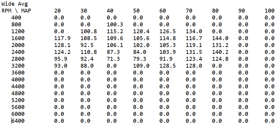

I had a problem with the injectors on my Fiero 85 V6 ECU 1226869 and swapped the original 5235210 (14.65LBS/HR) for ones from a 91 Firebird 17084888 (15.4LBS/HR), 5% more flow. The engine runs well, but smells a bit like gasoline.
I noticed that the BLM is always at 120 (=minimum), so the ECU constantly wants to reduce gasoline by about 6%.
Which value should I adjust with TunerPro to get the BLM to regulate again?
1.) Minimum BLM from 120 to 115? 2.) Reduce Base Pule Constant from 224 by 5%? Table "Base Puls Constant V. EGR Duty Cycle" also reduced by 5%?
Or another value?

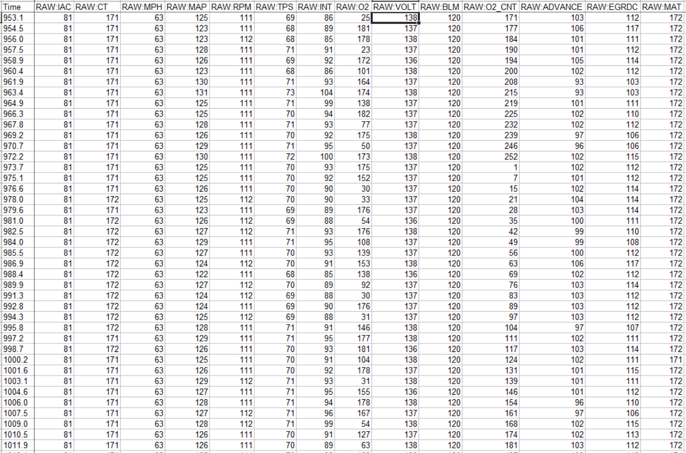

Is the BLM and INT staying static at 120?
jtontch
MAY 19, 12:52 PM
BLM is stable at 120, INT is moving.
