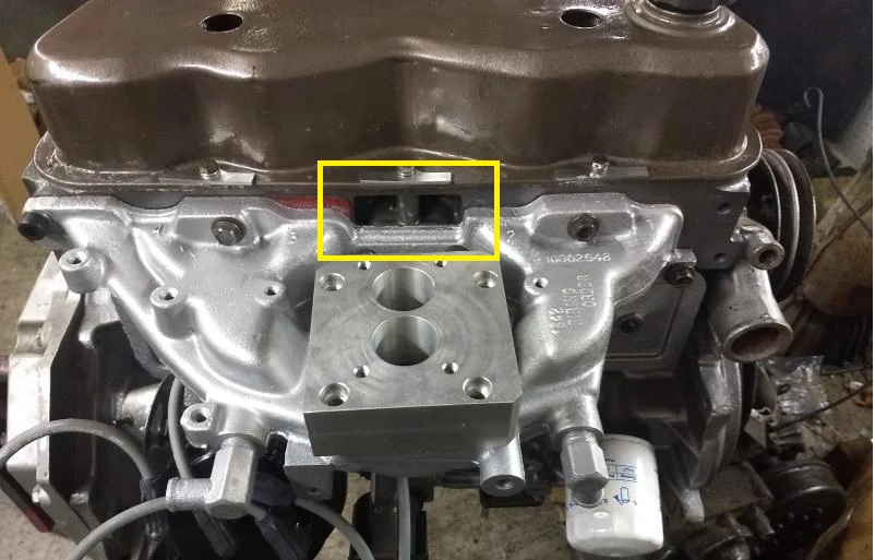

Best forum, newbie here owns a Pontiac Phoenix 1980 with, and here's the thing, an iron duke 2.5ltr engine.
Above the intake manifold are 2 inlets?/ holes in the middle that seem to me to find a way somewhere in the head??? I have the idea that false air is being drawn through these holes because my car idles very badly and when I spray brake cleaner above the sprout it starts to run better.
Question is, Are these air exchange holes for the emisie? Or does it have to be closed by a separate part?

Hello Patrick thank you for youre reply,

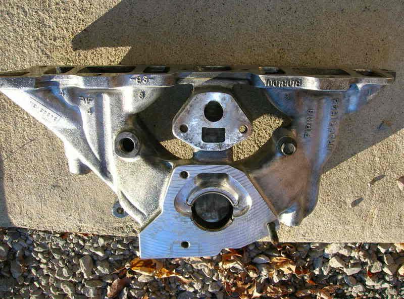

The picture is not my engine but excactly the same as i have. The yellow square is the issue. I have a an emision bracket on the inlet manifold under the carburator where the EGR is mounted on but don't have a cover for over the holes/inlets. If its mentioned to be so i don't know.

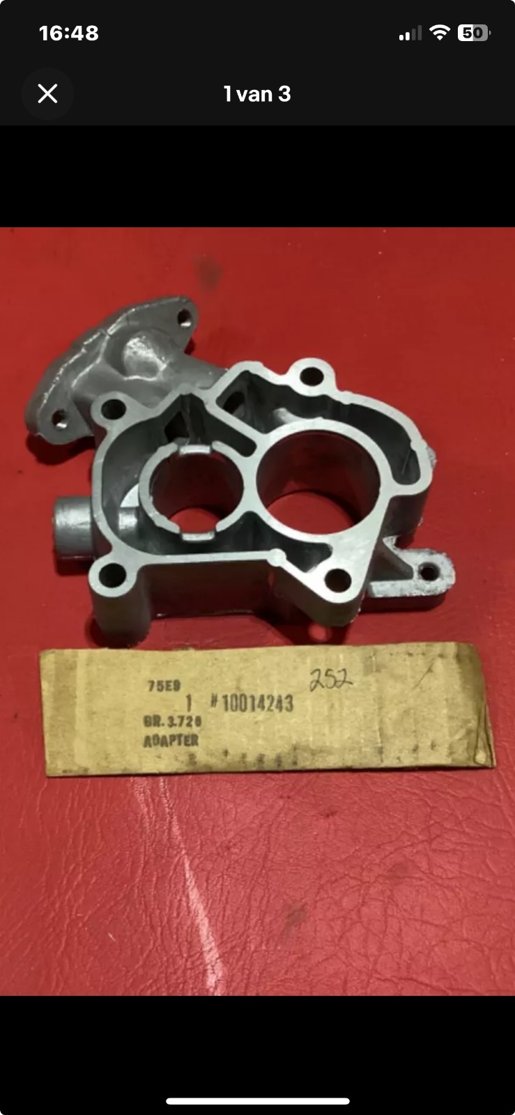

This is the emision EGR bracket. manifold site.

I would think those holes in the head are where the EGR assembly is supposed to connect. Is your EGR valve missing completely or what? You can't leave these holes wide open and expect your engine to run properly.

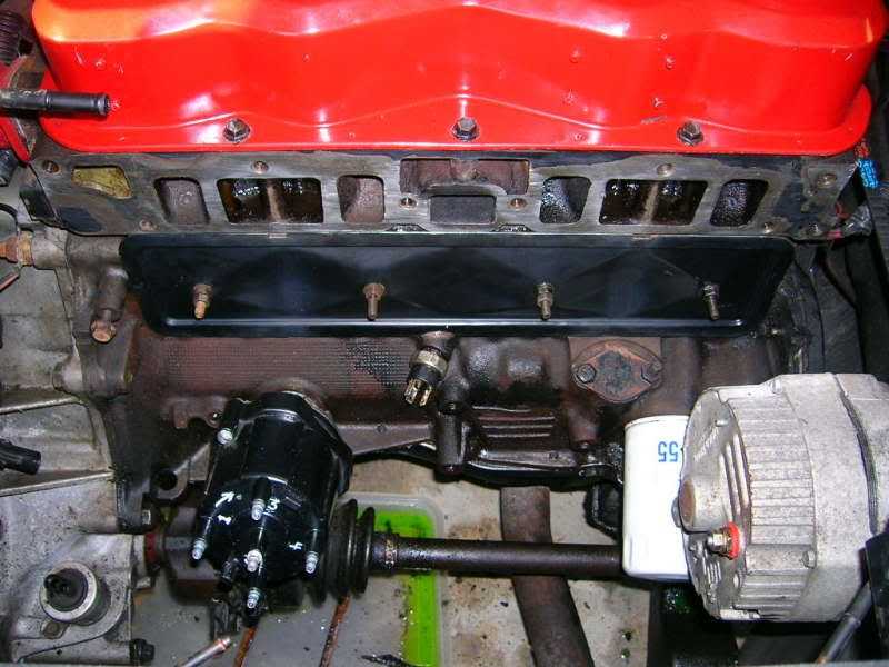

These are images I found online of an '84 Fiero 2.5 engine.
 [This message has been edited by Patrick (edited 05-22-2024).]

I was afraid of that that i have the wrong inlet manifold on the car. I've seen the manifold wich you show and the engine has the same looks as mine. But the manifold is what i can see not covering the holes in the head.

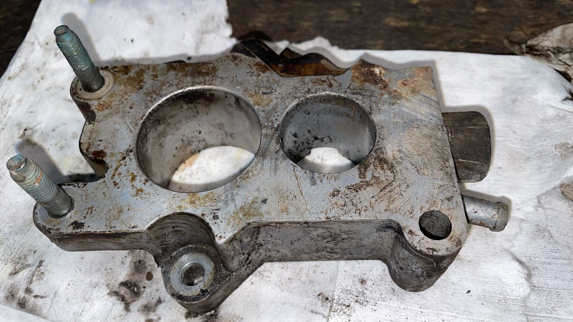

But the car run for almost 12000KM's reasanable properly til it started running misarable. So i demounted the carburator and discovered that the EGR adaptor wat torn and full of rubbisch. Bought the same and i fell in to trouble. Bought even a new carburator because the idle traject was stuffed.
In books and workshop manual i see only the manifold i have so i lost it completely????
old EGR bracket

Hopefully this helps?
Updated, see below...
Also, the Pontiac Phoenix is awesome... they're rare even here in the U.S.[This message has been edited by 82-T/A [At Work] (edited 05-22-2024).]
MAY 22, 08:20 AM
And to be clear, the "nothing" above the EGR port... those are just two impressions. They don't need to be covered when the intake is on. It's just part of the casting. They don't connect to anything and are left exposed.
