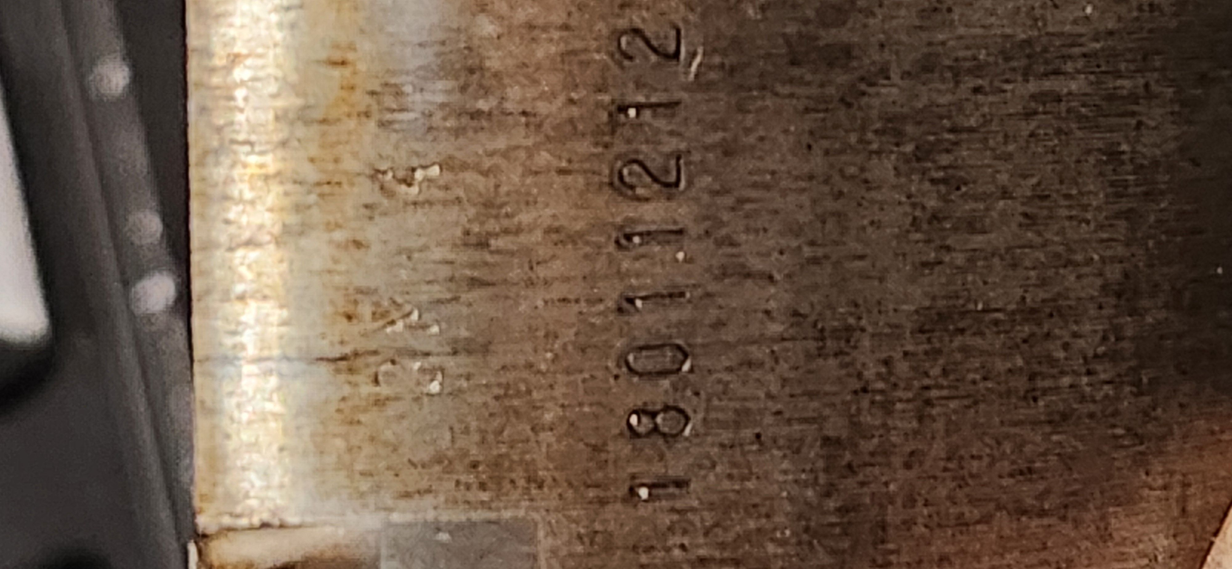

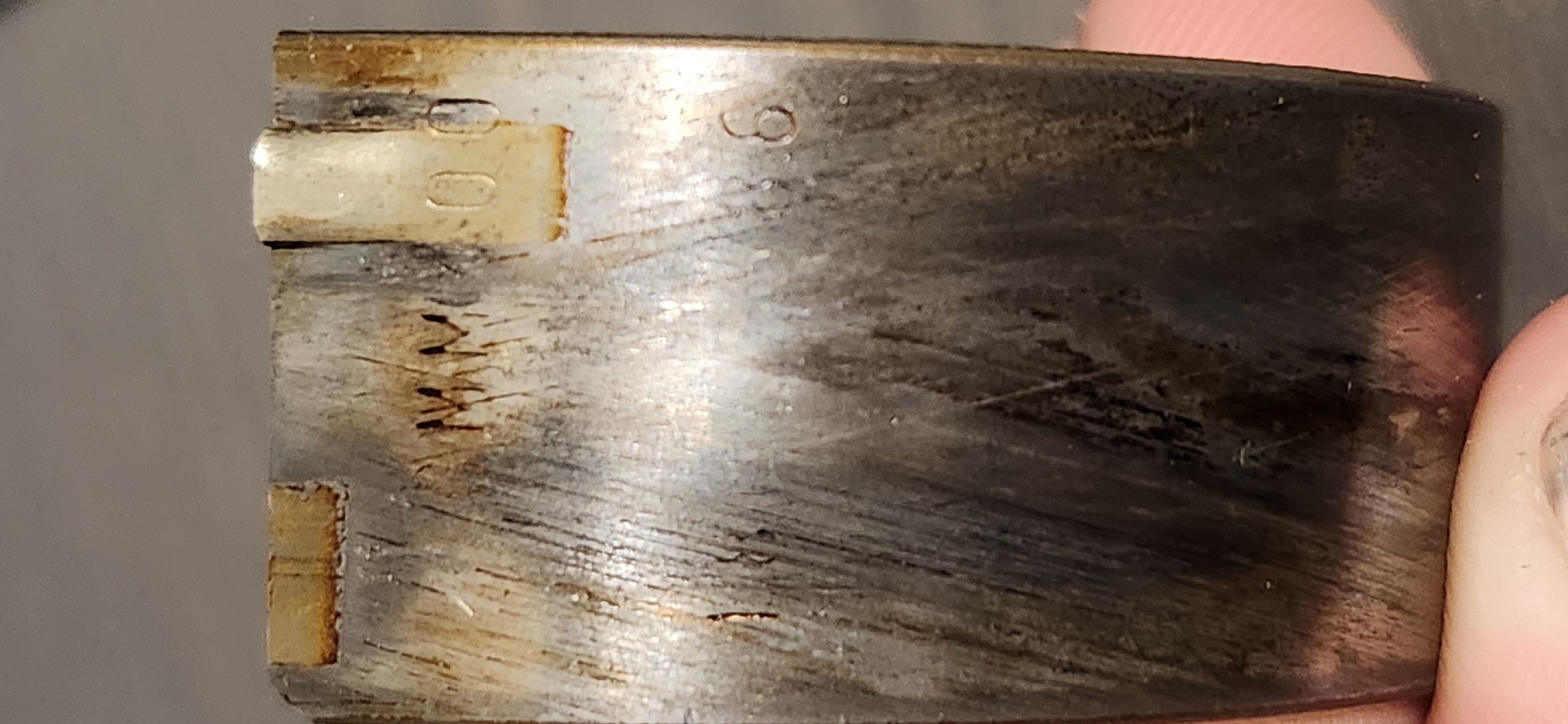

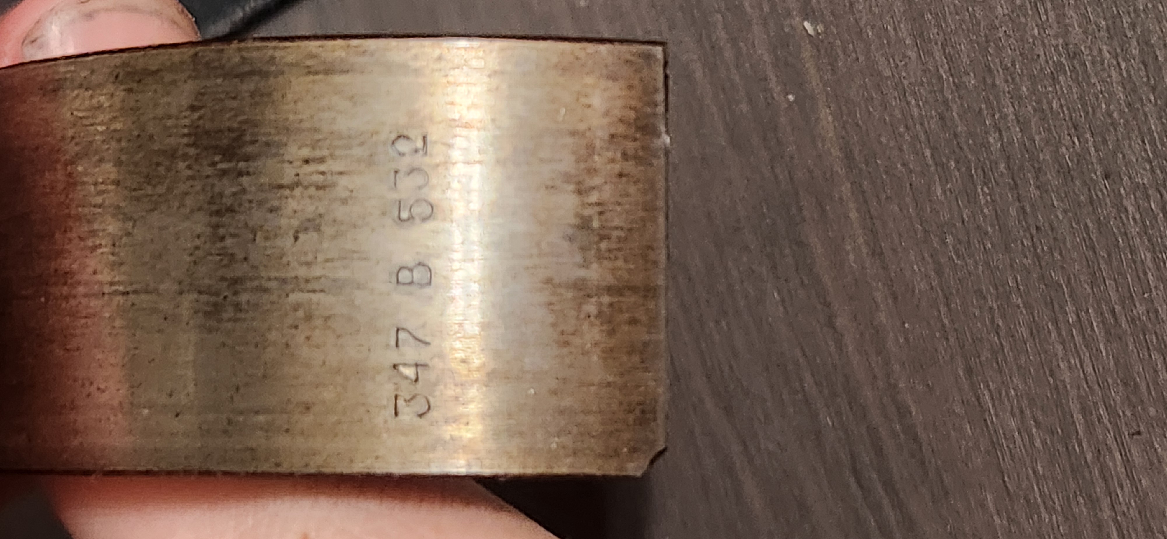

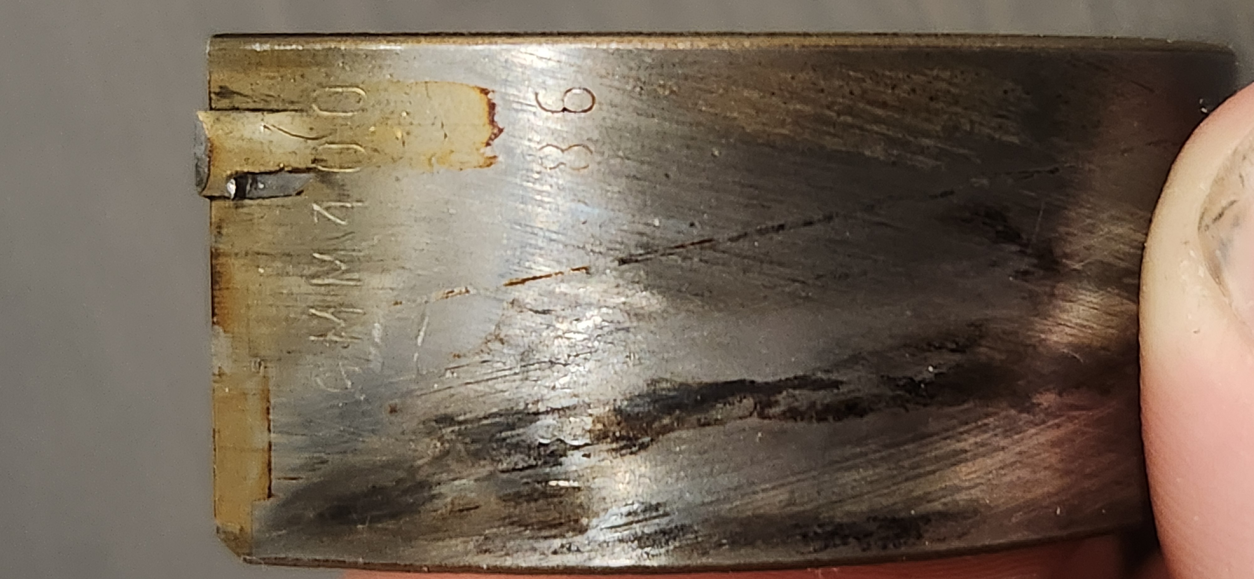

I have a 1986 V6 w/140k miles that I am replacing a number of things on due to low oil pressure at warm idle.
I am currently in the process of replacing the main and rod bearings, but have faced some confusion regarding what sizes to order.
I have photos of the upper and lower of one rod bearing, and the lower of a main.
As far as I can tell, both rods say MM100 and have a very faded serial number? on them 18xxxxxx86
They also both say 340xxxx31 (not pictured)
The main bearing has 2 very clear serial numbers, 18011212 and 347 B 532
It also appears as though it may have a very faded marking above the 180... reading 0M 4
I am really just at a loss here as to what sizes I should be ordering to replace these, as any examples of bearing sizing I can find online has much clearer markings.
Everything I can find is also in inches ex:0.03, and I'm assuming the MM stands for milimeters.
Any help is greatly apreciated.
Kit G

Notorio JUN 18, 11:23 PM
Patrick, yes one CAN replace the main bearing from underneath on the V6 at least.
Kit, you haven't mentioned the condition of the crank surfaces. The old bearings might look like sh-- but it doesn't matter if the crank is still fine. As has been send, Plastiguage will tell you what oversize to purchase. Good luck! You will be thrilled with the increase in oil pressure from replacing the mains and rod bearings.
