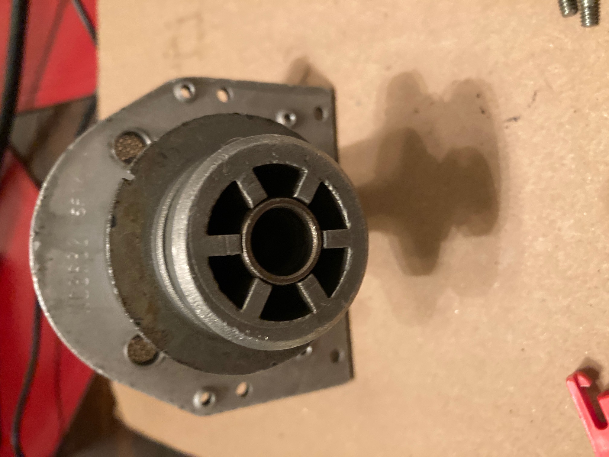

My daughter is rebuilding her distributor, and we took some pictures of it disconnected. In most engines that I've taken apart, the distributor and oil pump share the same cam gear... usually there's a hex-sided dowel that goes between the distributor and the oil pump. In the Iron Duke, the distributor has it's own gear off the camshaft (same with the oil pump)... which is actually a better design in my opinion. Though from what I can tell, the original design of the Iron Duke did it the same way.
Anyway, I could see no oil passages near the distributor, or anything that would insinuate that oil would get forced up into the distributor.
Looking at the disassembled distributor, I see two things:
There's open holes at the base of the distributor where it's bolted into the engine block.
... and the distributor shaft seems to have this spiral groove in it that I assume is used as a pump of some sort (or to create suction or vacuum, perhaps).
Anyone know exactly how the distributor gets oiled? Is there something that specifically splashes oil into and underneath it which then gets sucked up through this spiral groove cut into it, to help force it to the top... and then it drains out those holes?
Last question... can she use engine assembly lube on the shaft when she puts it all back together, or would it be better to just use normal motor oil? She didn't replace the bushing since there was absolutely no play in it.

There is no seal other than the housing gasket. Guessing as I never thought why before that seeing the disturber dive shaft is in that open bit of the block that magic happens and splashing oil / oil vapors is enough to lube that disturber Shaft?
Sometimes **** just works, don't question it[This message has been edited by jelly2m8 (edited 06-30-2024).]

Yeah, I saw a page on that which talked about "oil mist" being driven up there, but I've never heard of such a thing before in a GM engine. It's probably right, but just curious how it generates that mist. The concern I have is when my daughter re-assembles the distributor, is it OK for her to coat the shaft in engine assembly lube, or will that "clog" or prevent the mist action?

Just use motor oil that worried about it.
Get a lot of oil running off the cam bearings & lifters.
Lifters "leak" oil in their holes in the block on top of pumping oil thru the rods to the top of engine.
If you screw up putting the cover on the lifters, you will have big oil leak because that area is flooded when engine runs. ------------------ Dr. Ian Malcolm: Yeah, but your scientists were so preoccupied with whether or not they could, they didn't stop to think if they should. (Jurassic Park)

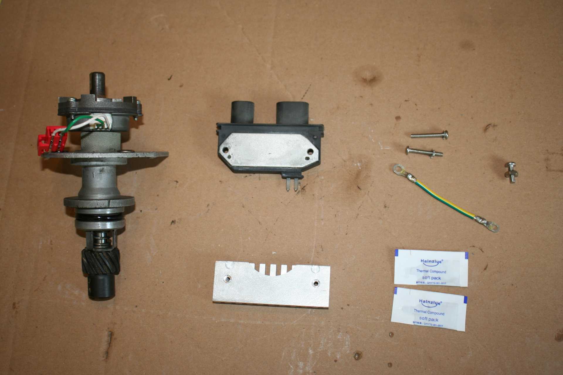

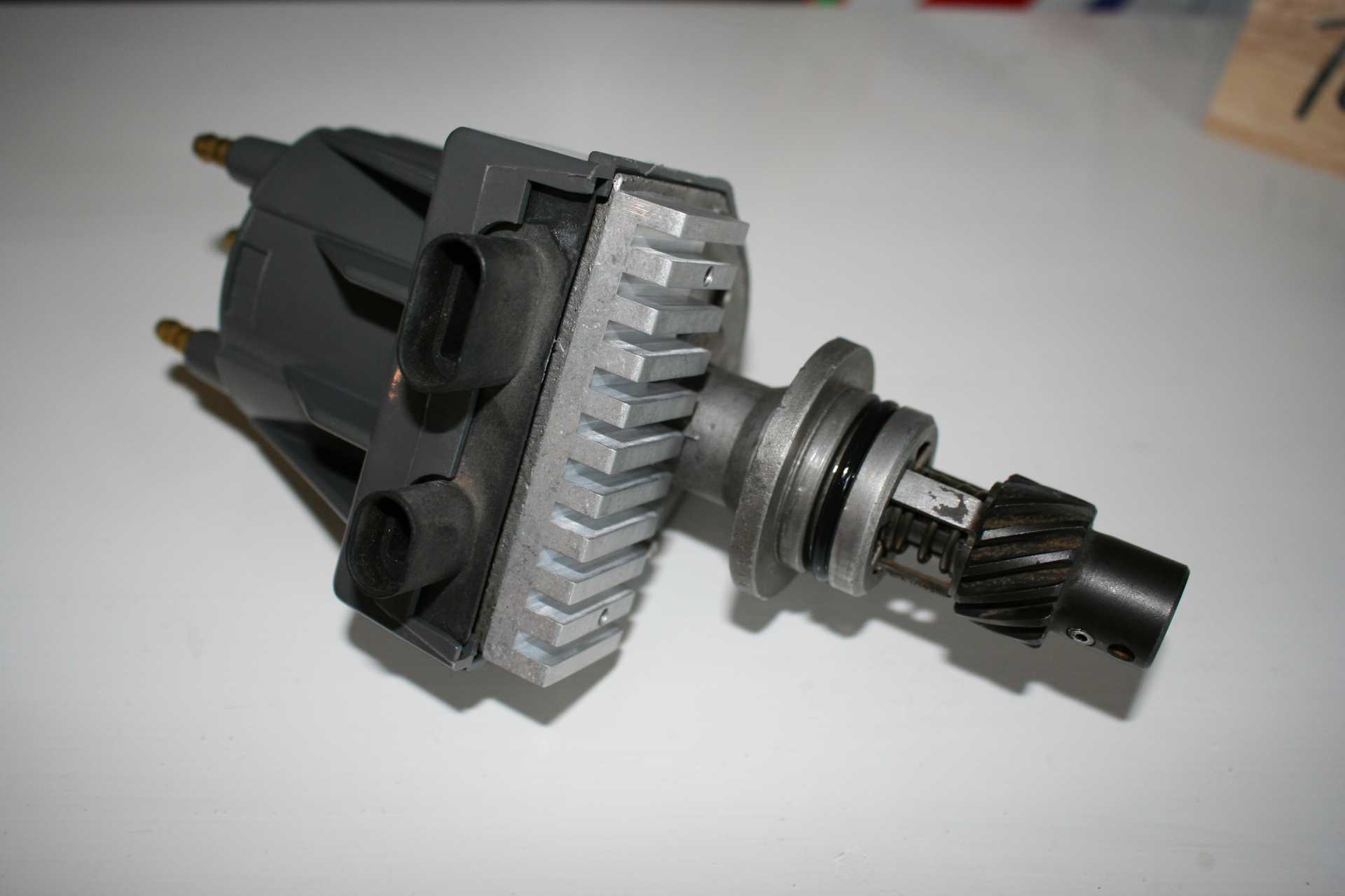

We rebuilt the distributor today. Slightly used GM ignition coil, new pickup / reluctor coil, new pickup coil clip, new magnet and bracket, O-ring, and of course cap and rotor. We also went with a heat-sink kit that I bought off eBay for $39 bucks, after I heard Patrick talking about something like this. Comes with a billet aluminum heat sink that's meant for a 3.8 distributor, but of course the distributor base is basically the same as they both use an HEI-8 ignition control module, so it fits perfectly.
The kit came with thermal paste for both the underside of the heat sink, and the underside of the ICM.
Worth mentioning, in order to get it to work, I was required to sand down (or remove) little tabs that stick down under the distributor housing. This is where the two screws go through the ignition control module and into the housing. The screw holes have additional meat (a tab underneath) that allows for more threads. I didn't like the idea of filing these down, so instead, we took a drill it that was the same size as the tab, and drilled into the underside of the heat sink instead, so that it would fit. It was minimal, but just enough so it would fit totally flush. The kit comes with extra-long screws that allow it to go through the ignition coil, and then screw into the heat sink.
Anyway, where I drilled into the heat sink, I expected it to be super hot, but the funny thing is the entire heat sink immediately became warm, with no single part of it being any warmer than the rest. Obviously, this is what a heat sink is supposed to do, but was impressed with how quickly and efficiently it worked.
This is what comes in the kit:
... note, it also came with a ground cable that attaches to the top of the ignition control module using the screw that tightens it down, and then you drill a hole in the distributor body and screw it in that way as well.[This message has been edited by 82-T/A [At Work] (edited 06-30-2024).]
