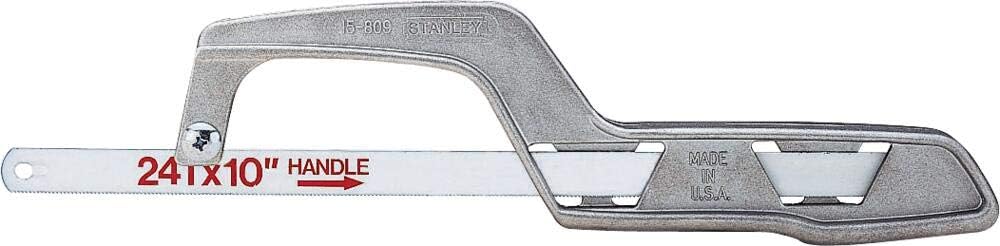

            Ugh, that is a bummer.  While I can't fully envision your fiasco, in a similar situation I used one of these mini hacksaws.  With patience, I was able to hack a bolt using the very TIP of the saw (i.e. the way it is in the photo.)
  managed to shove the compressor off and fixed the stud by replacing it with a new ace hardware one. took over 12 hours but hey the y pipe is the only thing that leaks... oh well that's what Flux core is for
  Yup  ....  when you have to resort to hacksaws or vice grips .... you have a fiasco on your hands.
  A 10K RPM grinder and a thin diamond disk is the high tech up grade.  And ... good safety glasses.
