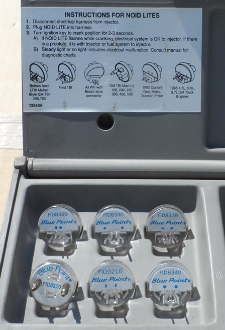

Here are a few Examples... Older Blue Point TBI/EFI Injector Harness Tester Kit, FID8838, is a set of 6, 2 or 3 to fit Fiero

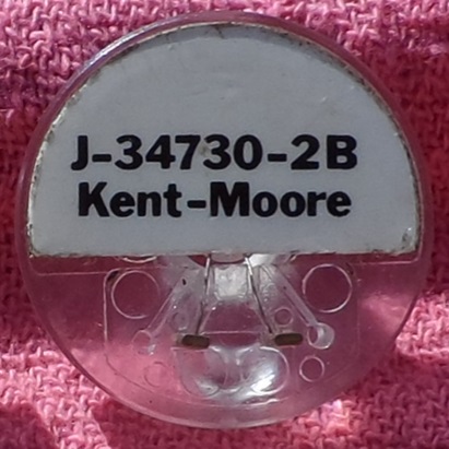

 I think the V6 & many other GM Port Injectors are shown above & looks sim to KM J-34730-2B...
 Is same PN in Fiero FSM but believe B is in this round format.

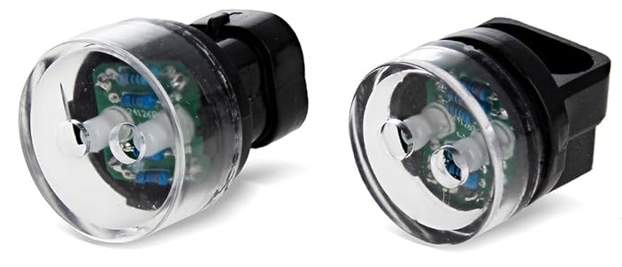

Again Can get kits or single units as new parts from other vendors but part numbers may not match. Text printed on them may not match application either...
 Actually plugs into 87+ 700 Series TBI & identical to FID8329

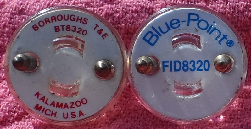

Notes: ● In the Fiero FSM is rare that a tool isn't a Kent Moore tool. BT8320 for older Duke TBI, BT8329 for 700 TBI were made by Borroughs T&E, Kalamazoo, MI

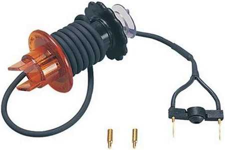

 ● GM/BT&E BTxxxx numbers matches BP FIDxxxx for both TBI Noids. ● Some Kits have Fiber "extension" so can view w/o help. Plug the noid same way then stuff the noid in the "cord" to light the fiber.
Or can get Lisle Universal Noid Light 27800
