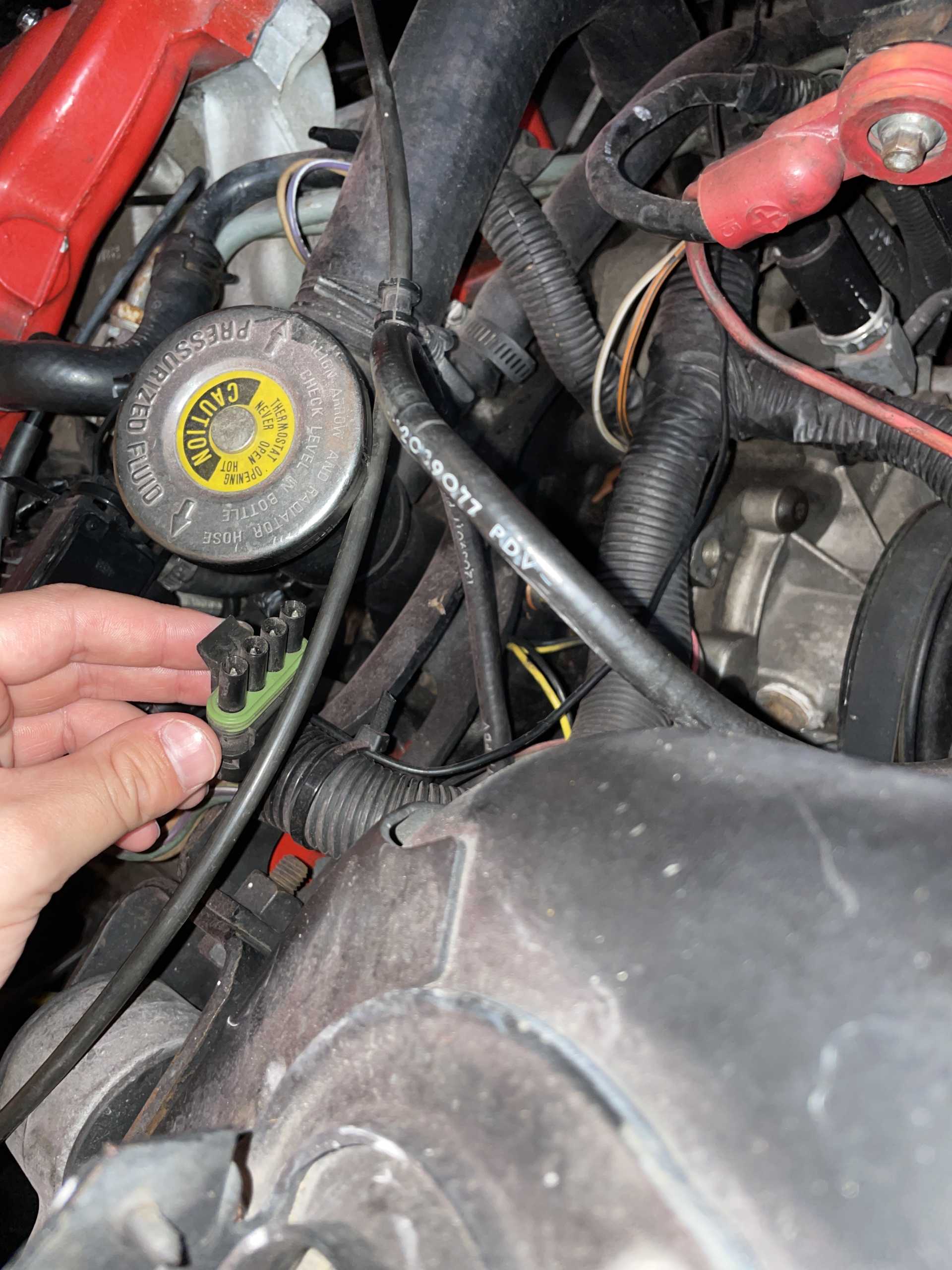

When I bought my 88 Fiero I did not realize all the emission components were taken out, this includes the EGR, vacuum canister, and the vacuum lines that go to them (ports plugged off). I am on the fence about if I should reprogram a new chip for an EGR delete. I used TunerPro with an ALDL to USB connector to see if there was any egr fault (and values), but I did not see any with my current chip. So I guess the previous owner actually had someone modify the chip to disable the EGR? Would no alarm indicate this? Also, I looked through the forum and found that my chip belongs to an 86 Fiero, however mine is an 88 3 speed auto Formula 2.8. The chip that is in there currently is: APN0154. I am in the process of working on my coolant system but before that I was getting Code 12 only. I never got a code 32 or any other code.

Is your EGR *solenoid* (on the passenger side of the engine) still there? There's some simple way to trick the wiring that connects to the solenoid so that the ECM thinks the EGR is present and defeats the error code. That might be all that was done.

Thank you for that chart! The EGR solenoid is also removed, the 4-pin connector is left unconnected.
