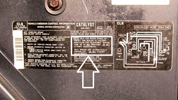

          |   | Vintage-Nut | AUG 17,  06:05 PM |  |
 | | quote |  | FieroMark: Who can tell me what the idle speed should be on a V6 GT?
 If you had the "Vehicle Emission Control Information" sticker on the deck lid, it says:
 "The idle speed is automatically controlled. Do Not Attempt Adjustments."
 And yes, my operating temperature idle is around 800-900 RPM too.....
