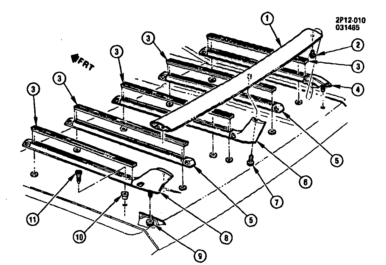

I need #3
The rubber strips that go inside the rack rails
