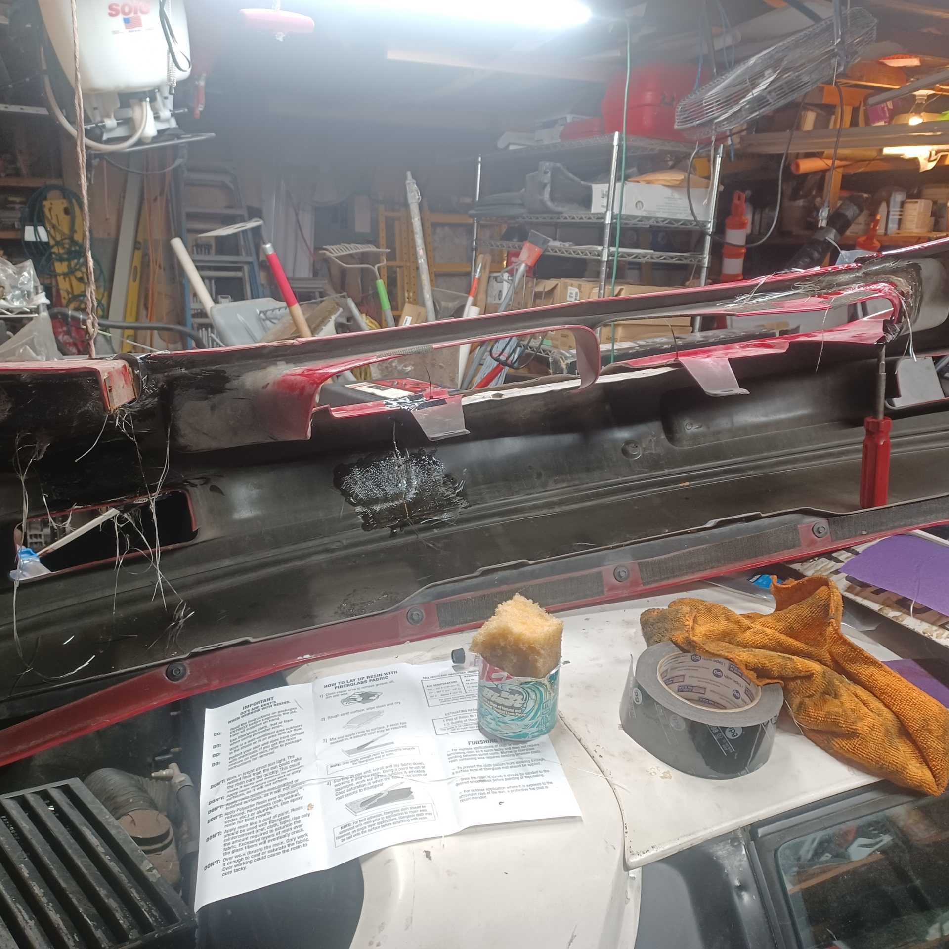

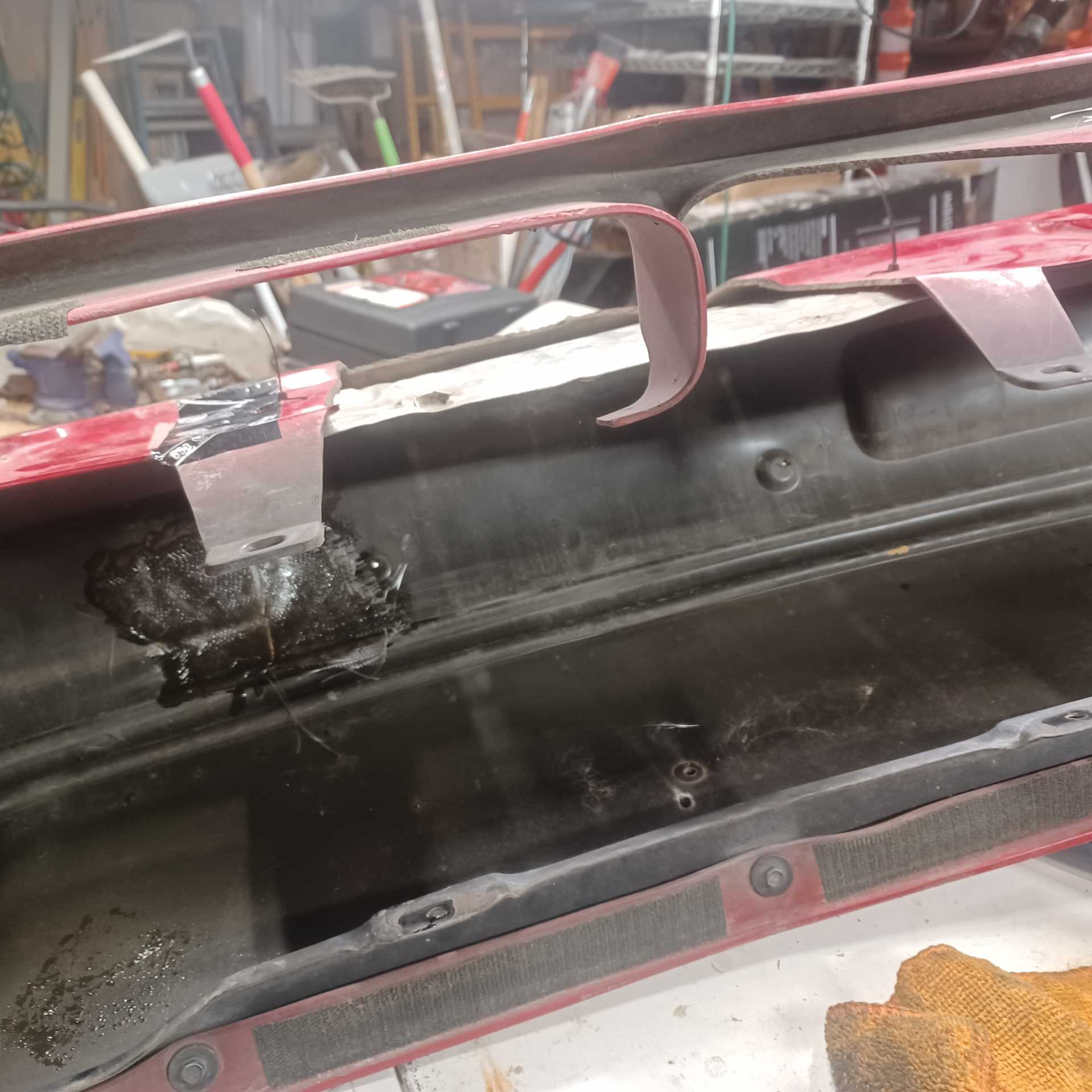

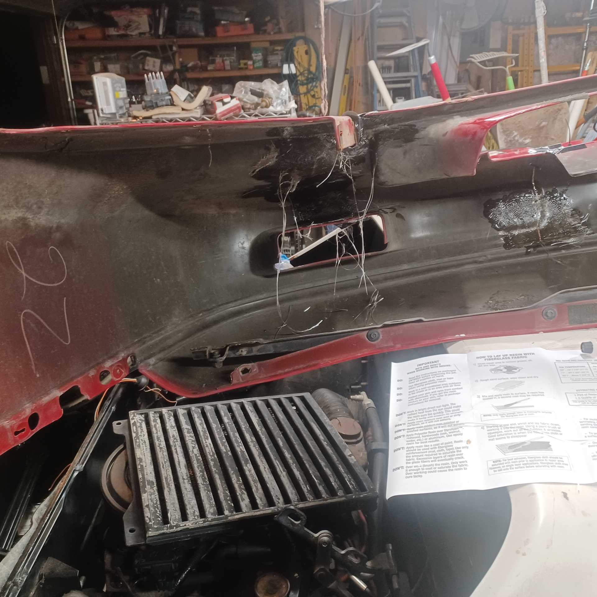

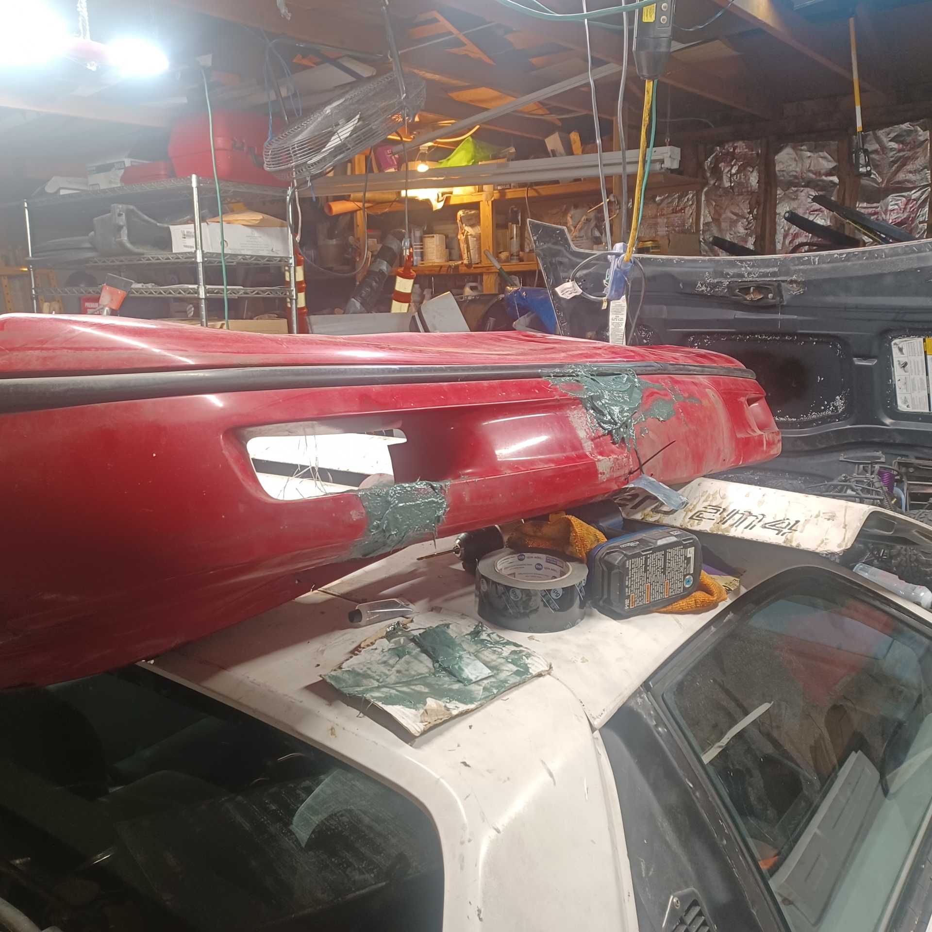

been fixing this poor condition bumper I got for free and I think it's turning out ok. still have some fiberglass work to make the 2 major missing parts (license plate is a filler peice to help me get the fiberglass to stay in place and maybe to help strengthen that area of repair depending on how much fiberglass and short strand filler i need to make it all disappear) to repair the chunk missing out of the lower ducts but hey it was the best I could get within a state or 2. as it turns out normal fiberglass and resin for boat repairs (long story) sticks very very well to urethane and will flex slightly with it. I definitely should find a more flexible resin but the worry is not having the proper adhesion at that point since most of those are expensive and really made for a corvettes more solid bumper.

Looks like you have your hands full with that one. you may want to consider building a fixture to hold it closer to it's final shape while you work on it.
You have some pretty nasty concave areas above the trim line. That's really common and seems to be accepted. Long ago I started a project to make a hard fiberglass piece to replace that section. Of course one needs a brand new one to make a mold, or a a mold made from scratch so ..... it's on hold.

that's because it's not mounted. when this was mounted on a car a few weeks ago it was fine and looked really good until we took it off and the cracks got bigger. on the bright side though I pretty much can't make this one worse ao the way it's been held together is with drift stitches then fiberglass.

i repaired mine with compound from Canadian Tire that is made to work with flexible bumper covers. Fiberglass is rigid and not a good idea imho.
i used foam sleeping bag mat material to stuff the area under the bumper cover and the metal, that way it put continual upward pressure on the bumper cover to prevent it from concaving. Still i have some concavity on the left side, so use more than you think you shud.

yes I know where it distorts. thus bumper doesn't have that yet since it was inside a barn most of its life. when fully mounted its 20x better than the aero nose I took off
