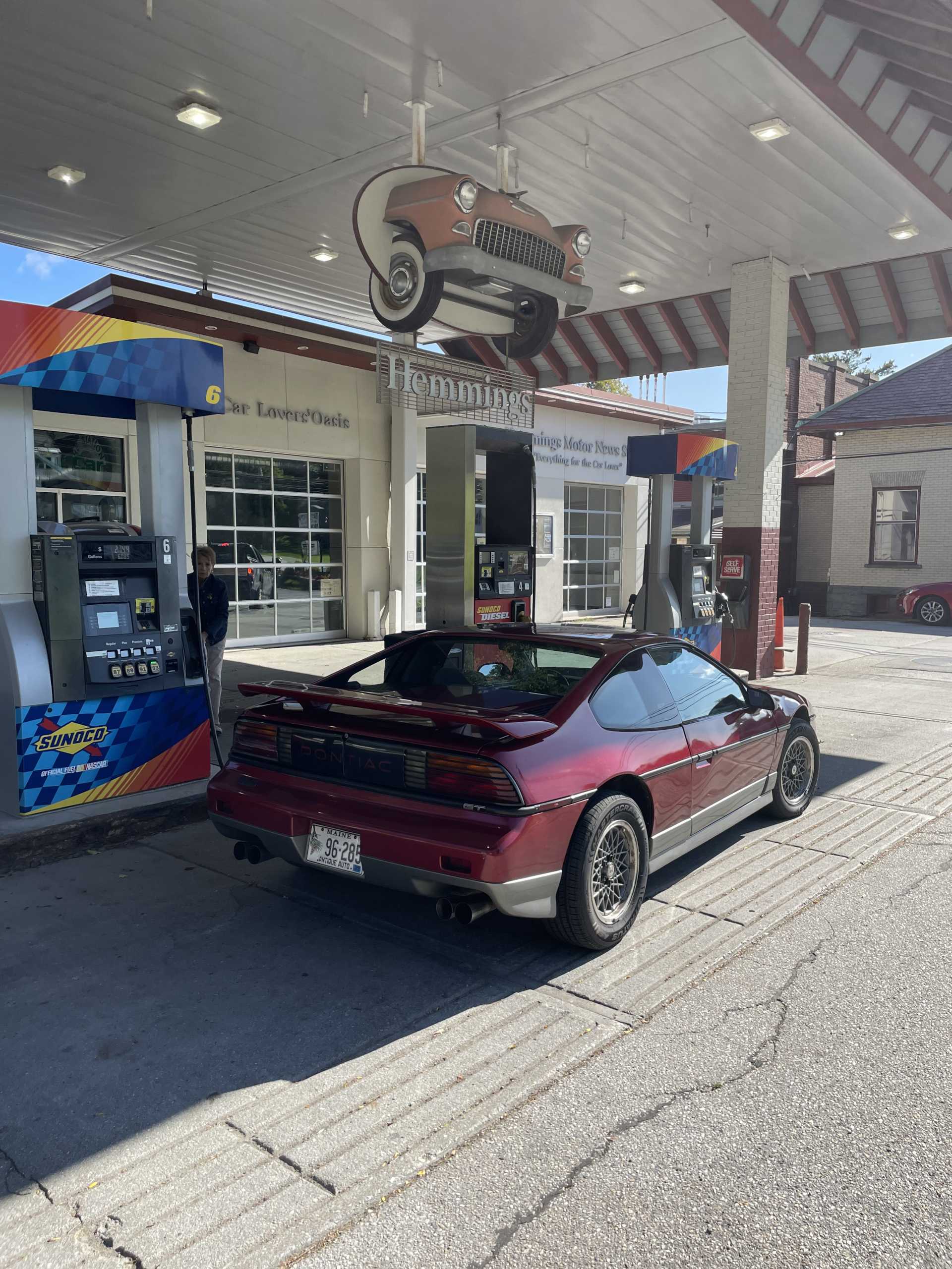

Otherwise, the car is sorted, rust-free, and has some nice upgrades.
