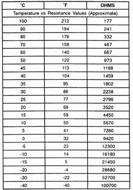

Your coolant temperature sensor might be giving false readings.
 If the ECM thinks the engine is warmer than it really is, it would explain the low idle and also why it idles better after 1 minute. You can just unplug the sensor and measure the resistance across the 2 terminals using a multimeter. I don't remember if the 4cyl has an intake air temperature sensor, but if it does, check that also. When you check the coolant temp sensor, make sure you're checking the right sensor. There's a separate sender that just goes to the gauge - that one won't affect how the car runs. The gauge uses a similar scale but it's not exactly the same.
1 minute is how long it usually takes for the O2 sensor to become active, which gives the ECM feedback to adjust the fuel mixture. Until that time, it's blind and just using the preprogrammed mixture based on temperature and manifold pressure. The preprogrammed mixture might be too lean (especially if it's reading a higher temperature than reality).
