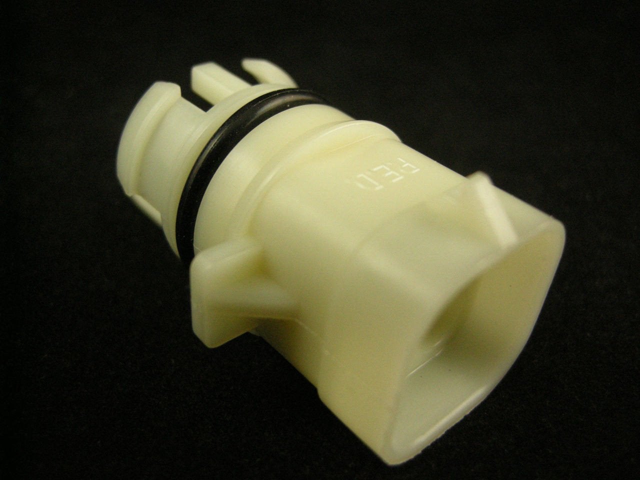

One more question tho mines a square not a circular connection is that not the th125 then, because I thought that's what was in the base 88 l4's
It looks more like this

That's just the external end. My view is the internal end.
