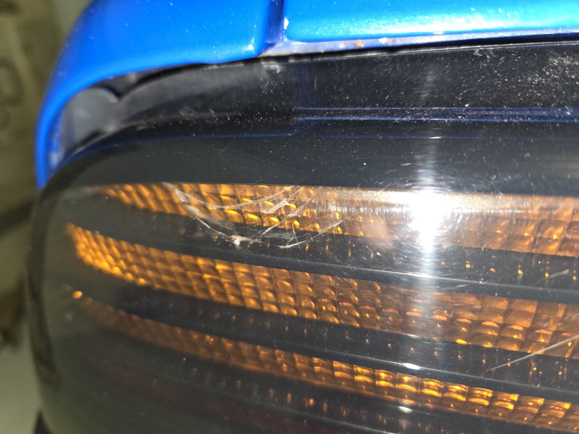

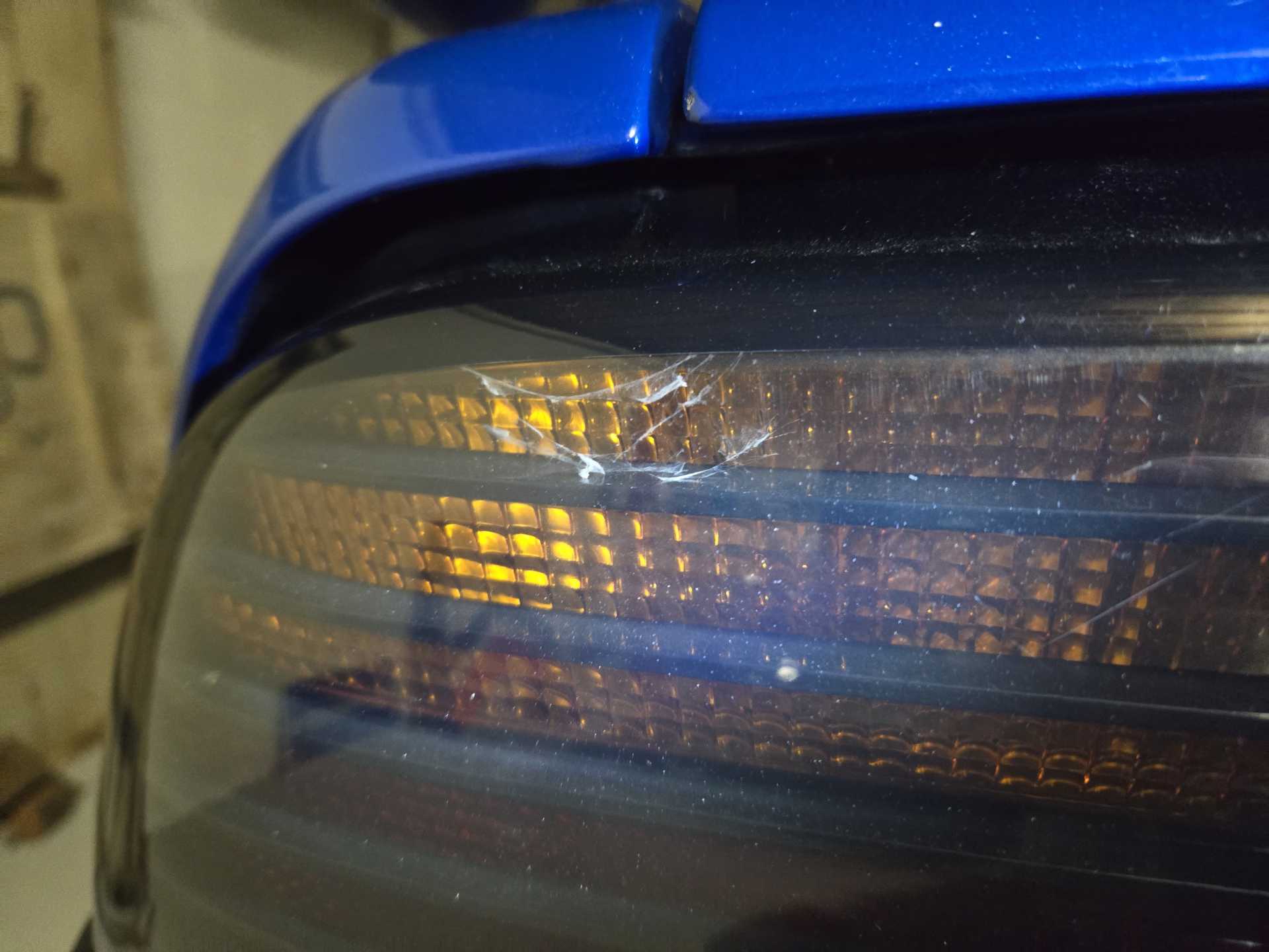

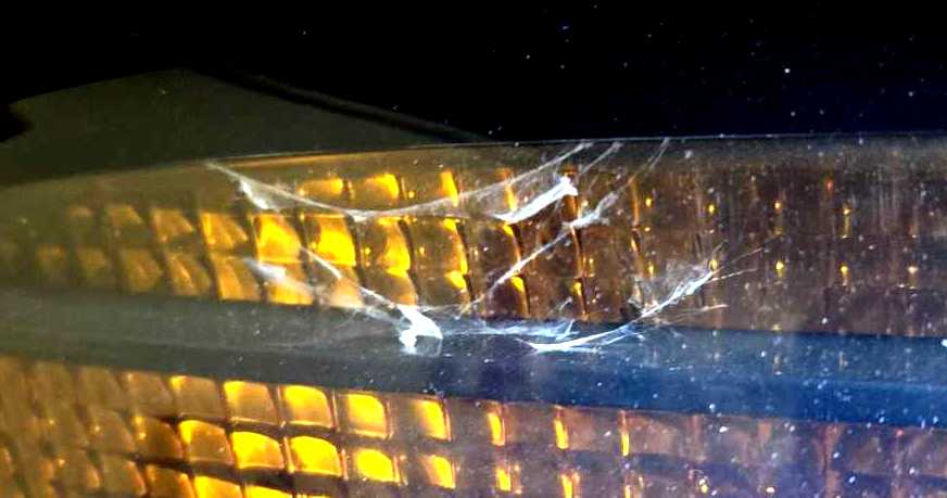

 I have an '87 Blue GT with 24k miles. It is a really nice, show winning, almost 100% original car. Near the top left of the driver's tail light a tiny spider got it and made a tiny web / home that was there when I bought the car. from 10 feet it's not noticeable, from 5 feet it looks like delamination, getting closer you can see it's a spider web. As the car is so original, and there are zero other issues with the tail lights, do I leave it as is or do I risk damage to remove the web?
Personally... I waffle back and forth. Some qualified feedback from my fellow Fiero enthusiasts should help me settle.
Thanks in advance, Sean
IMSA GT
AUG 30, 08:47 PM
Leave it alone. To separate the lenses requires you to bend the plastic tabs while trying to release the butyl adhesive that holds the lenses together. Too much risk with replacement lenses being obsolete. [This message has been edited by IMSA GT (edited 08-30-2024).]

It's a real spider web, not crazing of the lens.
Vintage-Nut
AUG 31, 01:36 AM
IF it is really a 'real' spider web; I agree and "Leave it alone" if Sean is an 'average' guy......
BUT Sean asked feedback without sharing his complete concern.......
The bottom line is "effort and time" to clean the web, and the "risk" is low IF they are warmed-up.
If the web 'bugs' Sean - "Fix It". Many will say, "Don't Bother It".[This message has been edited by Vintage-Nut (edited 08-31-2024).]
