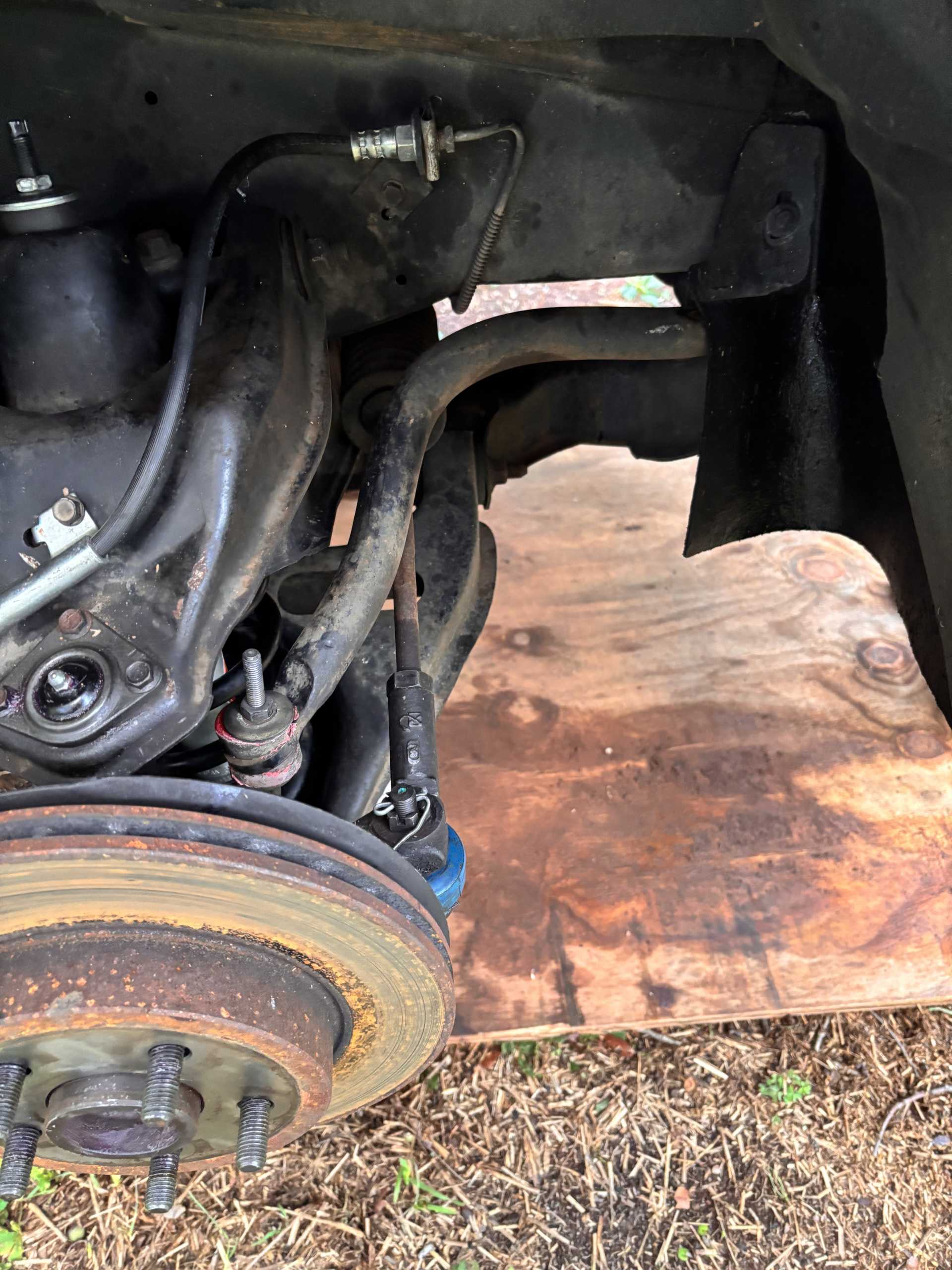

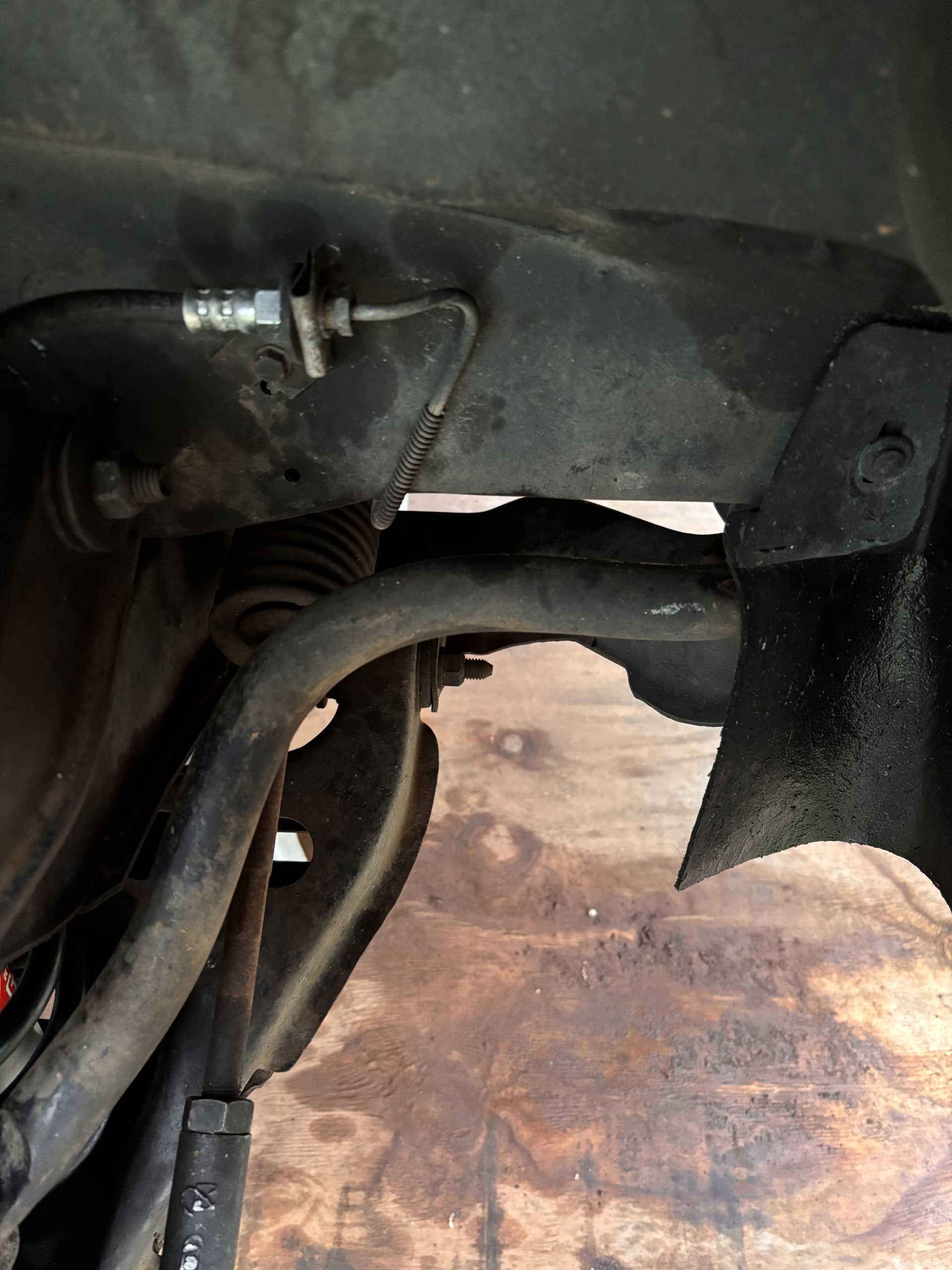

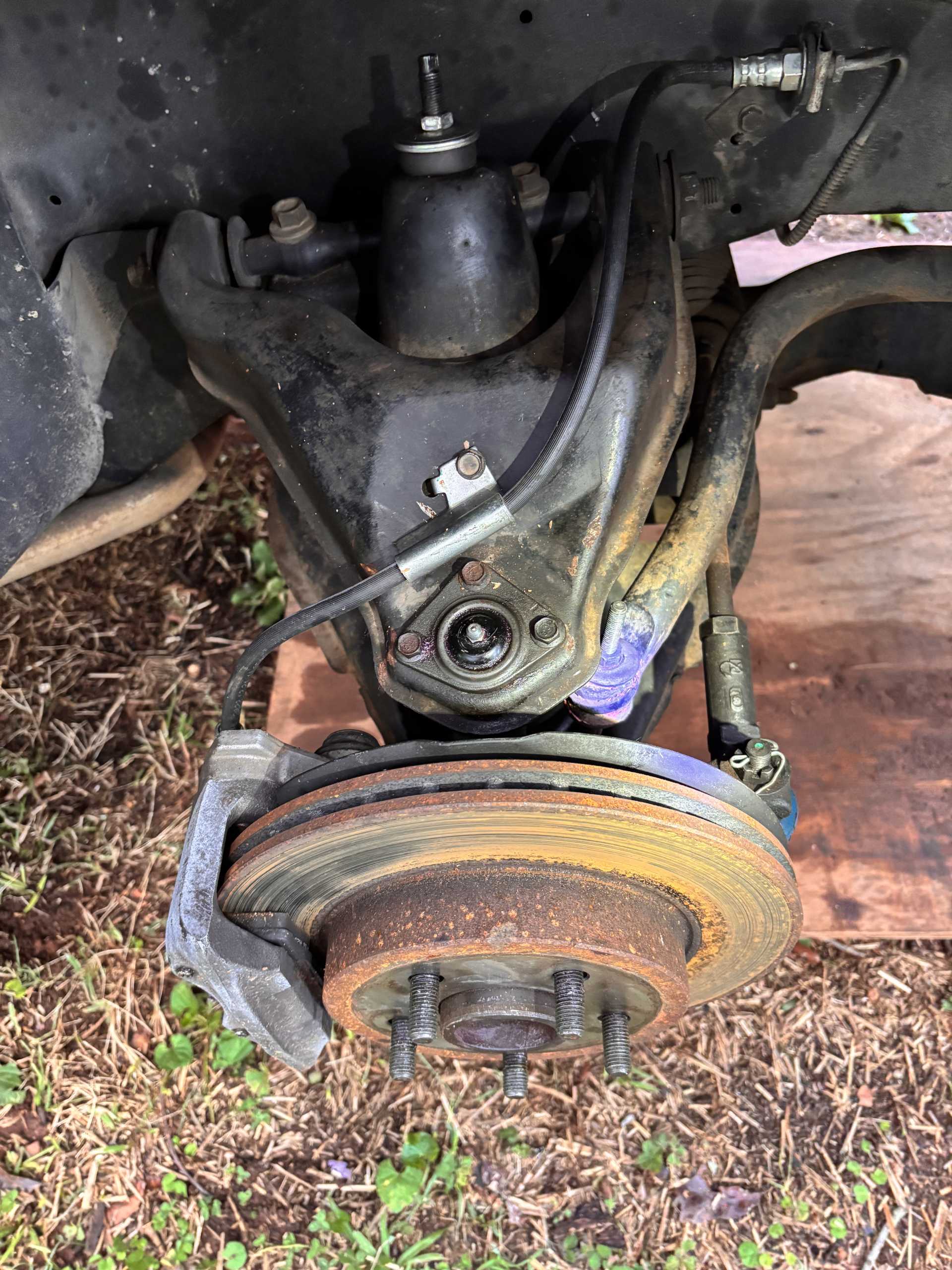

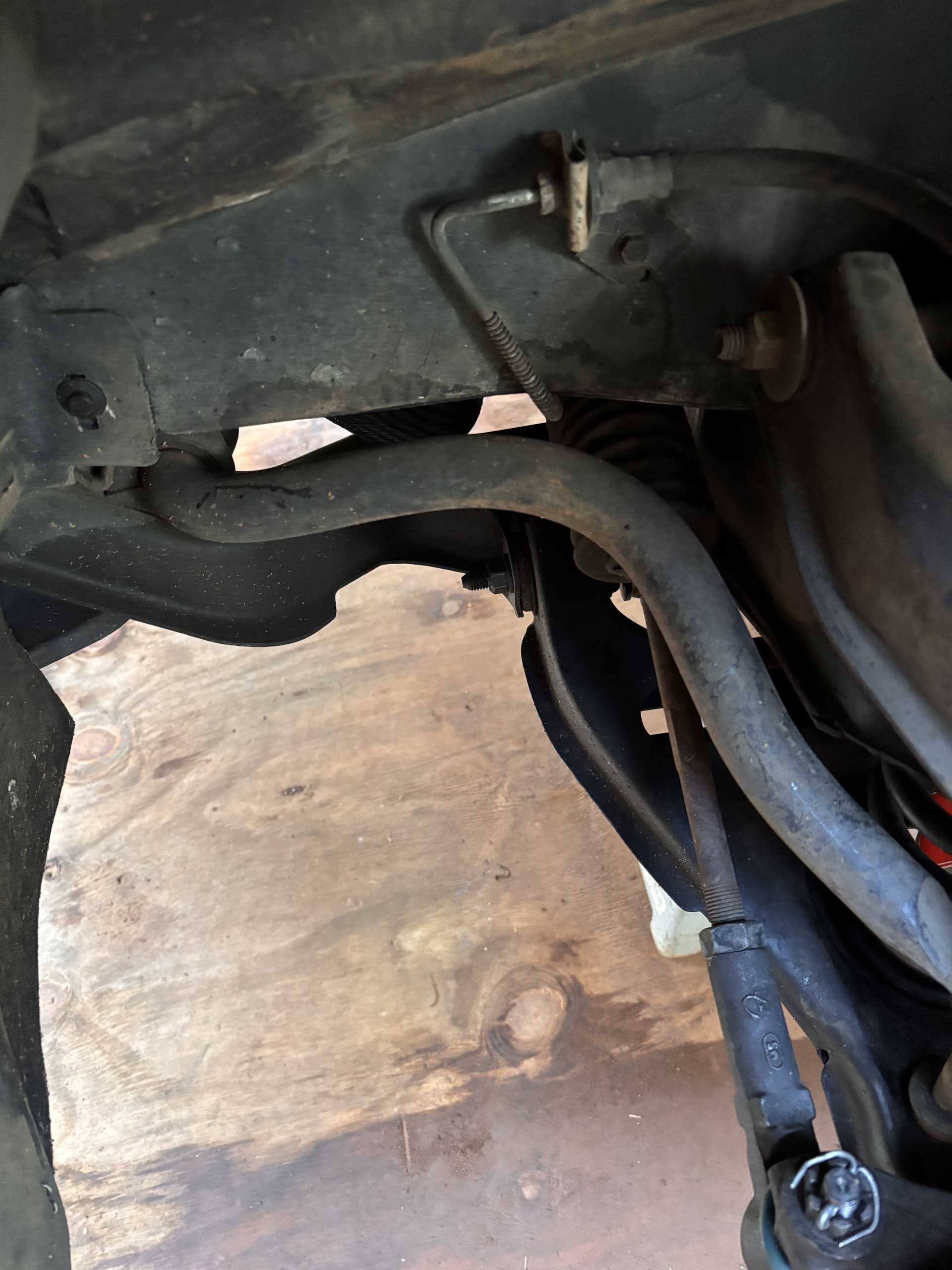

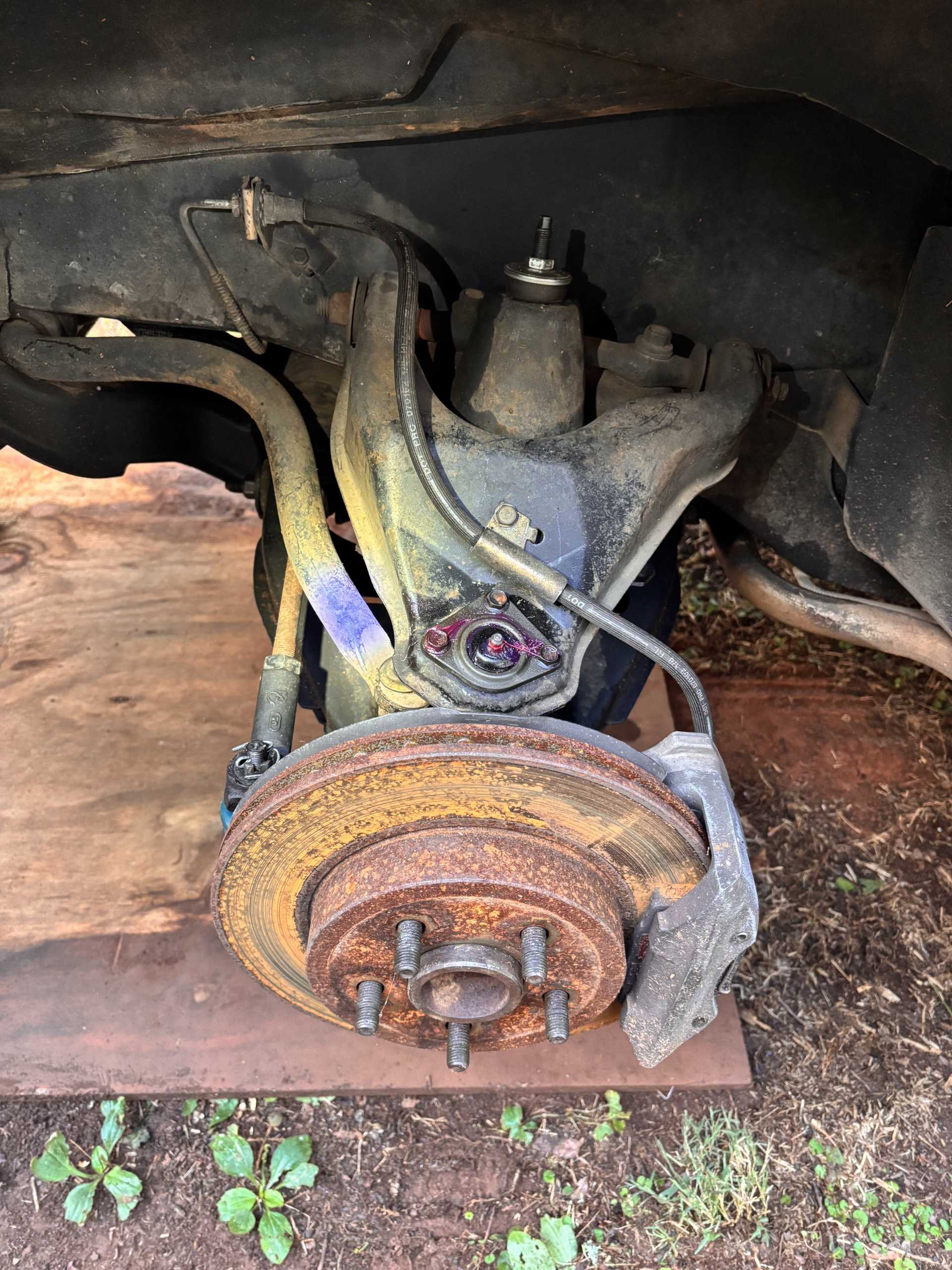

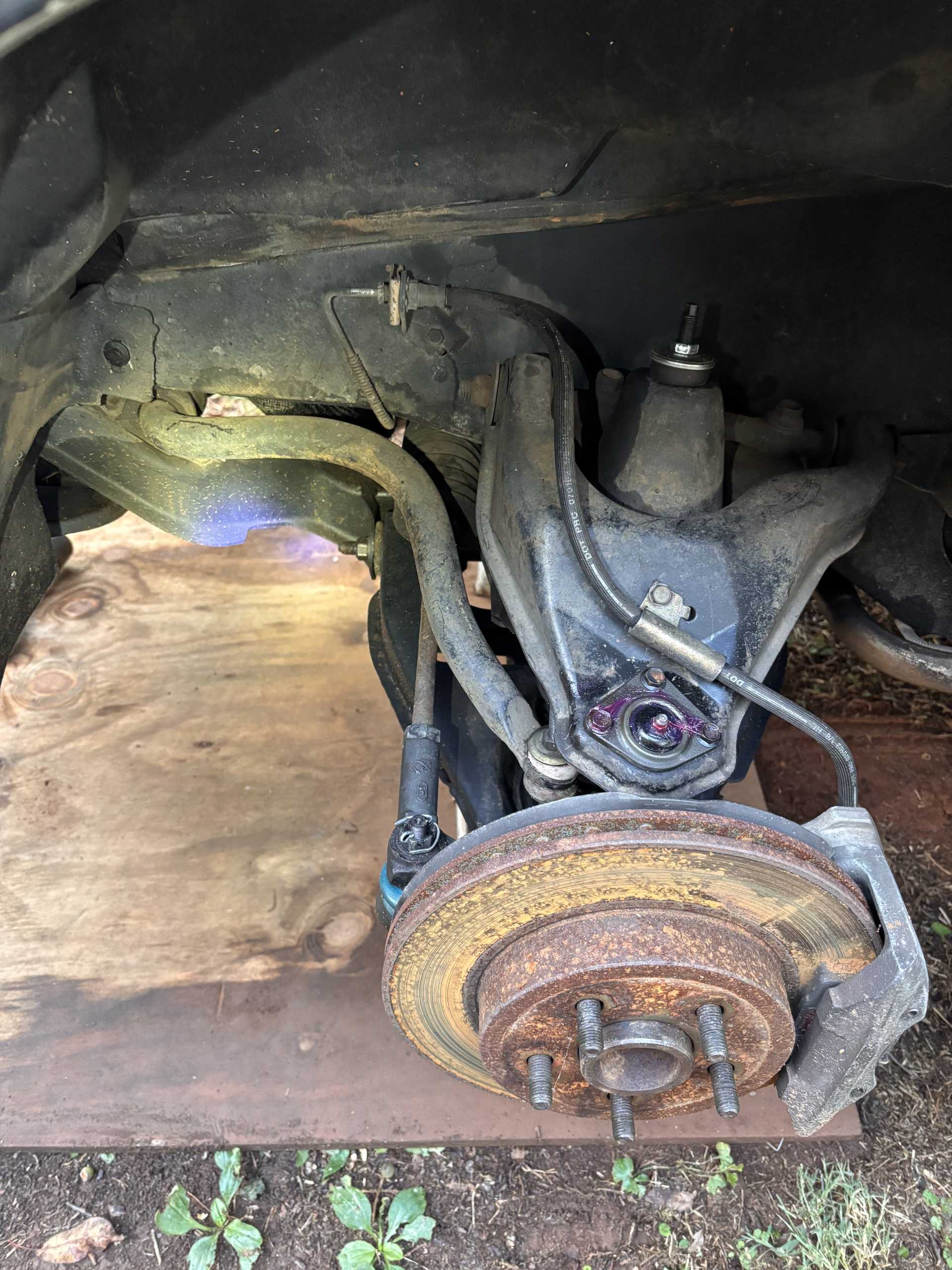

So here are a couple of pics from side to side.
Tried to get the angle right….

So here are a couple of pics from side to side. The front suspension is totally unloaded. Tried to get the angle right…. |

The sway bar brackets have some slop in the positioning. The front crossmember is only pinned on one side, so the other side can be forward or back from there. The Upper A-arm also has a lot of movement with the slotted upper a-arm holes.
Before getting too concerned with the position of the end links. Check the caster setting from side to side and check the wheel base from side to side. If either of those is different, it could easily explain the sway bar end link issue.
