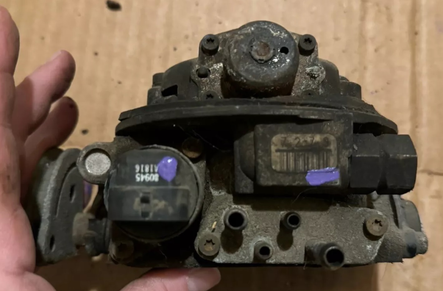

Hi! Best bet if you're getting a code 45, is to just replace the O2 sensor. They're fairly inexpensive. Get something like a BOSCH or a DELCO-REMY / AC DELCO / DELPHI.
As for the IAC, it's under the air cleaner, attached to the TBI unit. It has a 4-pronged connector on it, and it needs to be specific to your year. Sometimes people replace them from a different engine or GM car, or even forget to re-install the spacer, and then the Idle Air Control valve cannot properly adjust the idle air... so you get what you're getting now... almost stalling.
Let me search for a picture and I'll edit / update this post.
EDIT: Ok, I'm having trouble finding what I'm looking for... but this is your TBI unit (which is located under the air cleaner):
(Note: these are not my hands, not my TBI unit... I just pulled this off of eBay)
There is a sensor / actuator (as you know) called the Idle Air Control valve. It looks like this (Rock Auto): https://www.rockauto.com/en...rol+(iac)+valve,6072
Looks like there are two torx screws that hold it down, and it should just slide out.[This message has been edited by 82-T/A [At Work] (edited 09-17-2024).]
