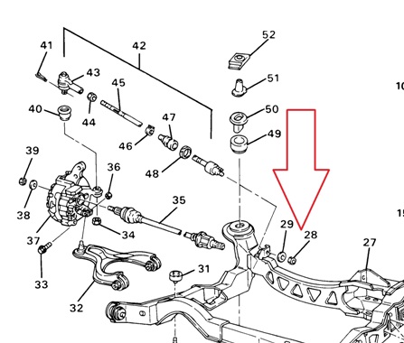

1985 V6 SE, automatic. Working on getting transmission off, I’ve got the cradle out and the last thing I need to do is get the axles out of the hubs and the transmission lifted.
But, I’m trying to get the outer tie rods off to get enough suspension movement—I have a tool to do it, but it’s just getting grease everywhere and not moving the tie rod.
Is there a way to remove the axles and transmission without removing the tie rod ends from the knuckle?

When I dropped my cradle, to disconnect the axle from the transmission (I left them in the hubs), I pulled the struts apart, and disconnected the inner tie rod, it's just bolted in place, not the press fit of the outer tie rod. To get the outer tie rod off, I just use a hammer on the nut partially threaded onto it
fieroguru APR 16, 06:48 AM
You can disconnect the tierod from the inboard mount. That is just a single nut, and then you don't need to mess with the taper on the outboard end.
