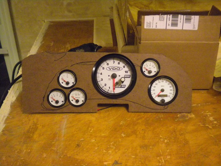

Just finished the cut outs for the gauges. Pics by Friday.

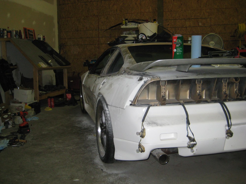

OCT 04, 12:18 PM

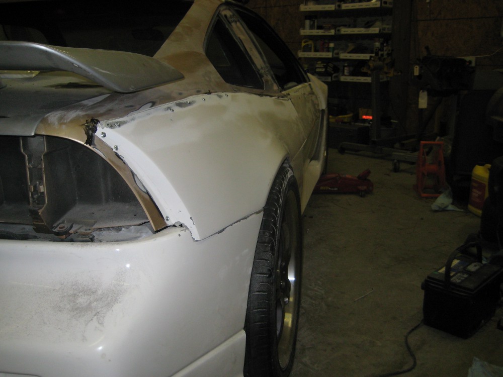

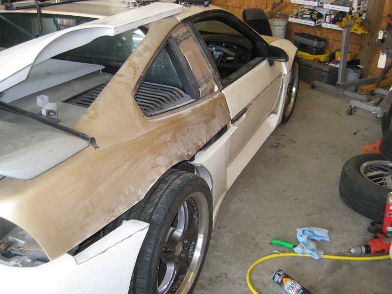

Not much exciting going on. I am continuing the wiring (car side) today. Additionally I am finishing mounting the body kit tonight. I can't say enough good things about the body kit fit. Archie has a great product. I plan to have everything ready for primer next week.
After that stage will come engine mods. I am trying to get 300hp at the wheels. I will swap blowers to a '94-'95 style and drop pulley size down as far as I can go, 36lb injectors, and a reprogram. I think that should just about do it.

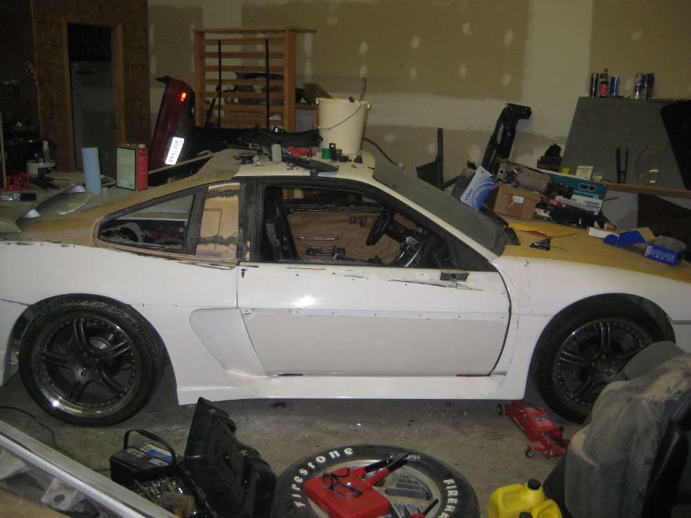

OCT 12, 11:04 AM

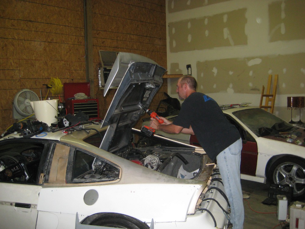

Just an update. I have installed rivet nuts on the doors and rockers. I have lined up all body parts and will be doing bonding of door and fender caps. I removed the front spacers as they just pushed the wheels out too far. Whade Duck and I installed the Mustang scoop on the decklid and cut a large hole under it to vent the engine bay more.
I sent the chip out to be reprogrammed too.

Been fiberglassing. Post pics later this week. I forgot how much fun it is. I created more work than I wanted jajaja.
