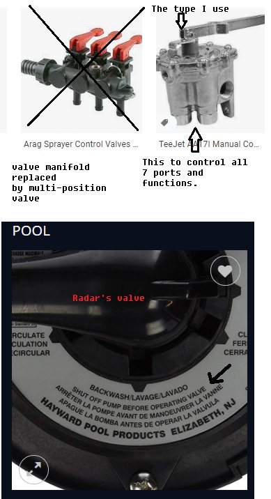

I use a similar 7 position multi-directional valve on my high volume pasture spray unit. You must not switch valve positions while the pump is running. It allows the pressure to get between the gasket and it's mating face and lift the gasket, causing it to tear when you turn to the next position. here it is: http://www.inyopools.com/Ho...e.aspx?CommentPage=1[This message has been edited by maryjane (edited 04-04-2021).]

| quote | Originally posted by maryjane: You must not switch valve positions while the pump is running. It allows the pressure to get between the gasket and it's mating face and lift the gasket, causing it to tear when you turn to the next position.
Ok. I know nothing about what you are talking about, ... but ... I know a lot about valves, pumps and running pressure loaded pumps.
It's possible to switch valve positions while a pump is running and a line is pressurized. You gradually open one while another is being gradually closed.. Equalizing the pressure.
It's possible to switch valve positions while a pump is running and a line is pressurized. You gradually open one while another is being gradually closed.. Equalizing the pressure. |
Not on the kind of valve maryjane is talking about. Look at the picture in his link.
When you push down on the handle to turn the valve, everything is open at once and there is not much to hold the gasket in place.
Generally, in these applications where a multi function/multi position valve is used, there is no other valve. None needed or desirable. I've been using the same multi position valve for about 10 years now. Trouble free as long as they are flushed out occasionally and ya don't let them freeze.
