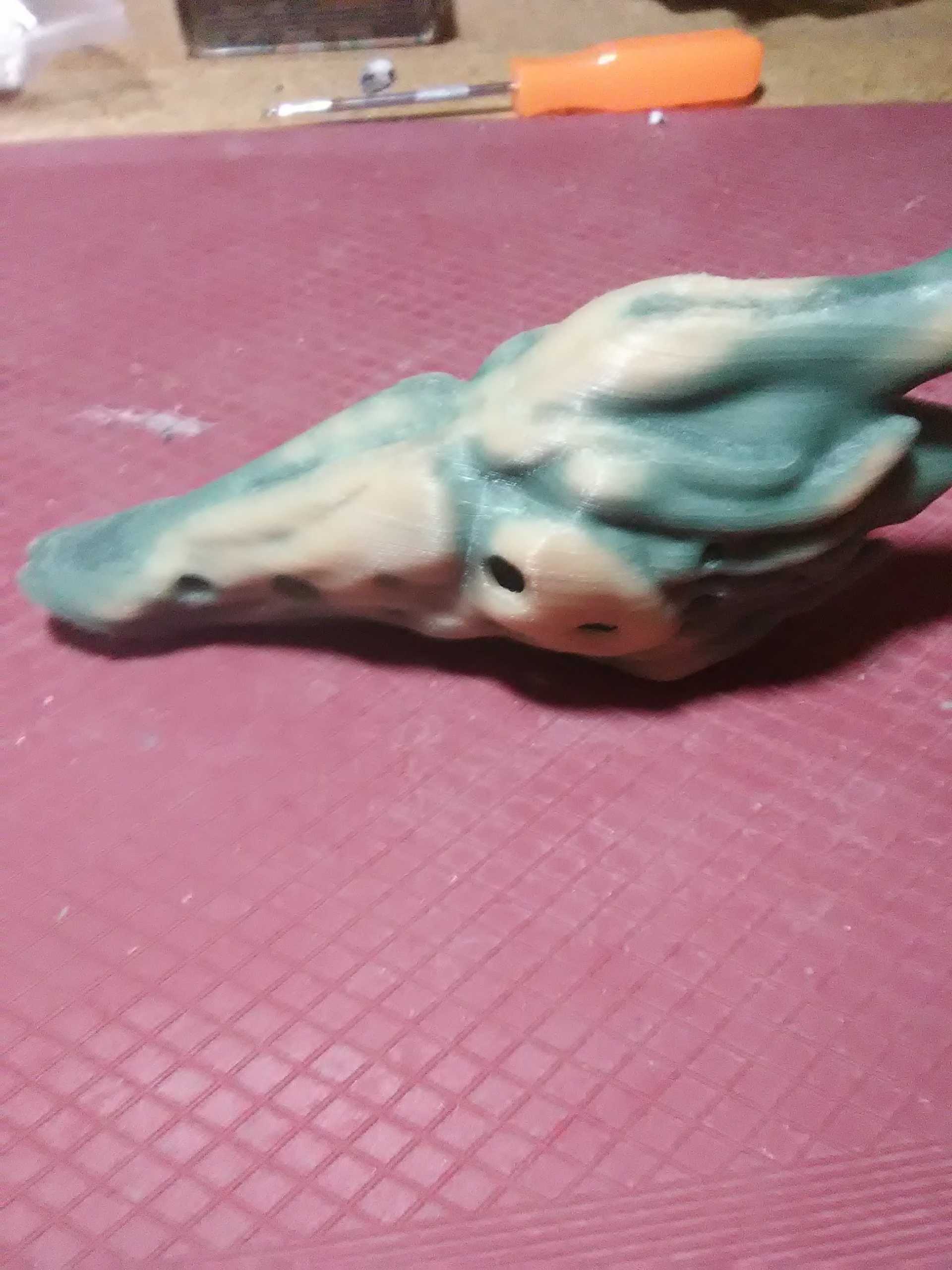

I've got a roll of Lava filament kicking around, it goes from black-dark green-tan-orange-yellow with temperature changes. I'm thinking kids will go mental over a raptor resonator that changes colors wherever they touch it or blow into it. Worth a shot anyway to fleece the parents while the brats piss off everybody in earshot....er....I mean, provide their wonderful children with hours of joyful entertainment. .[This message has been edited by MidEngineManiac (edited 04-19-2021).]
APR 19, 06:35 PM
Print it out of a hard material, it will sound better and louder. A soft material will dampen the vibrations of the air, and the sound comes from the air. It is a fipple flute, like a whistle or a recorder.
APR 20, 08:00 AM
Apparently, I am only capable of using this thing as a whistle.
I can get it to make noise out of one hole only, and as soon as I cover that one up it goes Simon and Garfunkel. Ah, well, they aint meant for me anyway.
Turned out nice though. And it took 20 minutes for the first order.
 [This message has been edited by MidEngineManiac (edited 04-20-2021).]
APR 20, 11:46 AM
It depends on a pressure wave generated at the open hole nearest to the fipple. That wave travels back to the fipple and bounces the air column upwards, briefly lowering the pressure in the chamber.
Look for obstructions, slag, anything that might disrupt the pressure waves. Try covering all but the farthest hole from the fipple. Try varying your air speed/pressure. Too much pressure can overwhelm the returning wave.
You are not covering the fipple are you?[This message has been edited by williegoat (edited 04-20-2021).]
