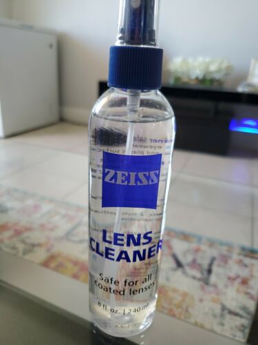

AUG 08, 01:49 AM
About $10 at Wally World
I originally started using this on my Nikon camera lenses and reading glasses.
Spray on a soft cloth, not directly on the screen.
Keeps all my lenses and screens clean, static free and happy.
