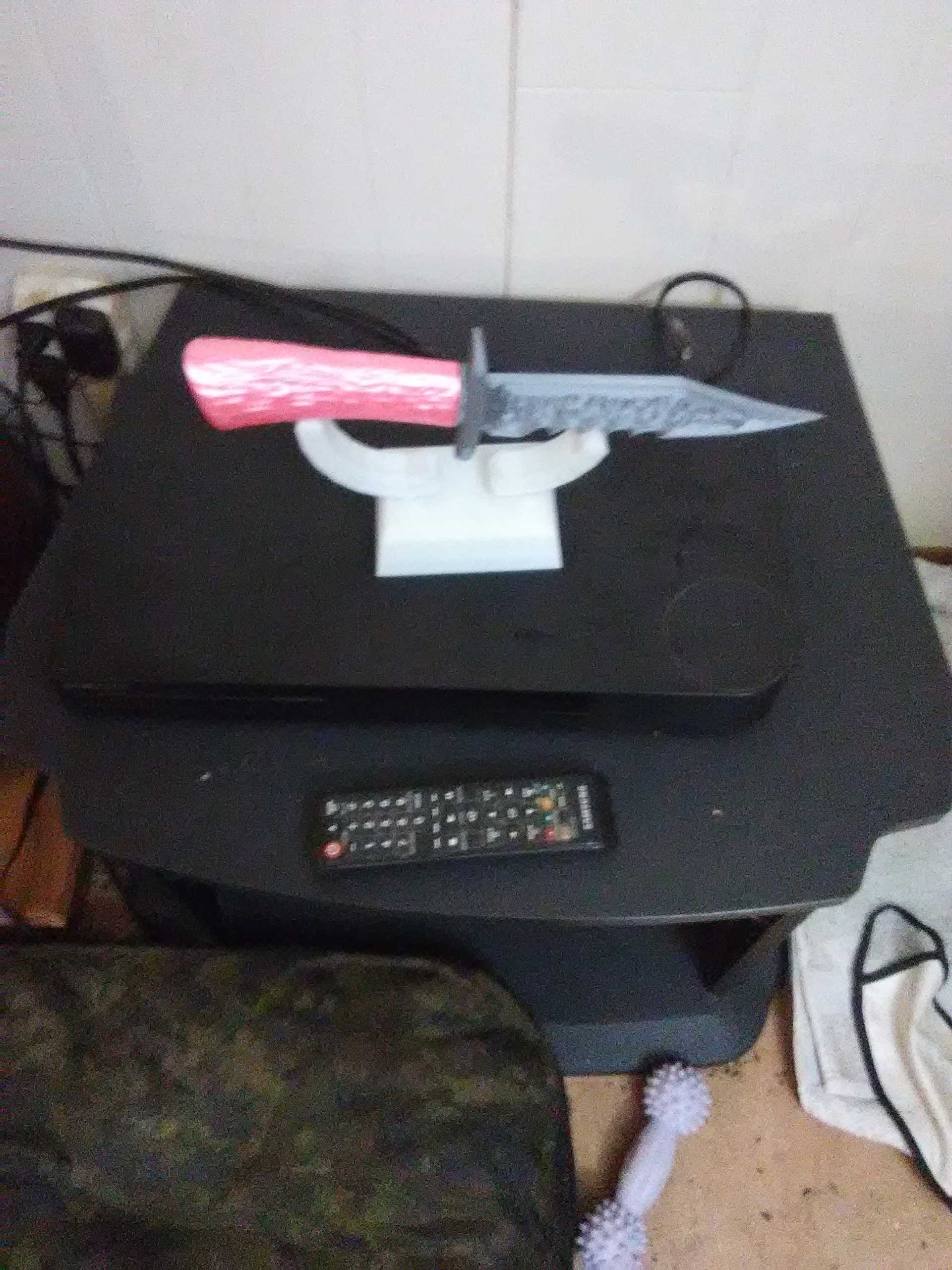

"Ruby's Blade" from Supernatural, just need the handle painted. That's a weeks groceries for doing basically nothing.
