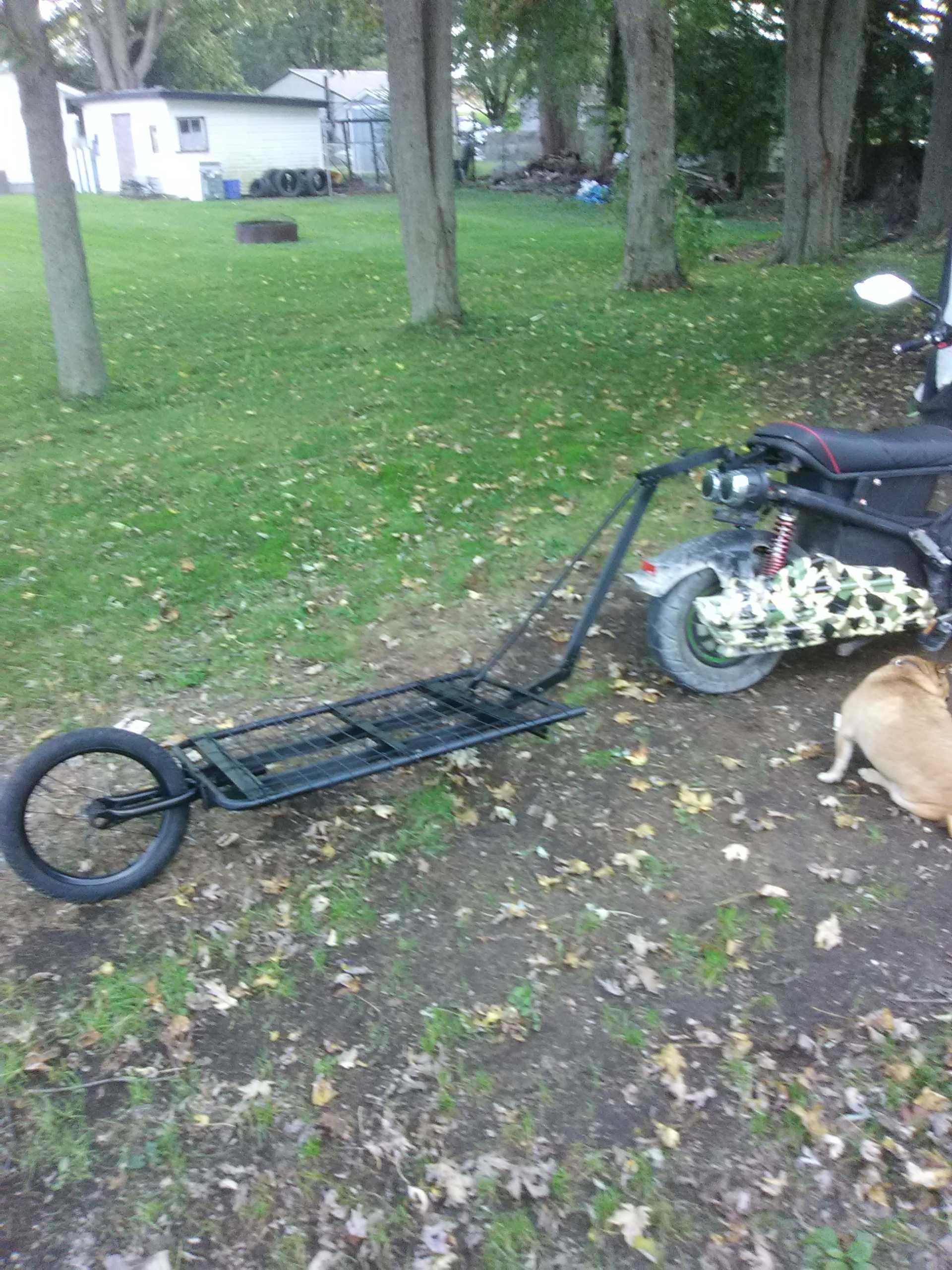

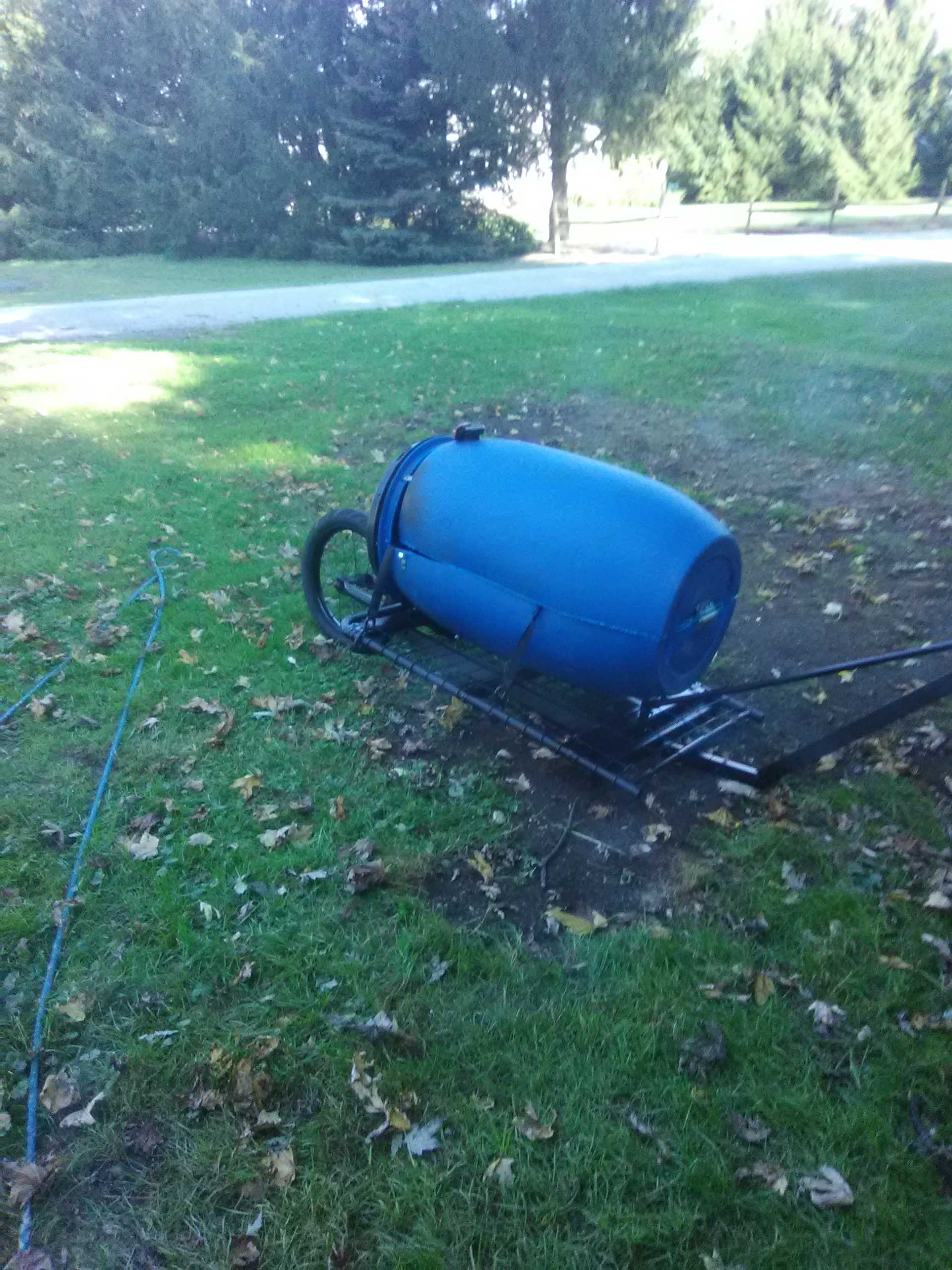

I am cobbling together a bit at a time a little monowheel trailer. The "body" is a 35 gallon plastic barrel, the monowheel is the forks and front wheel salvaged off a kids bike, the frame is 3/4"x 1-1/2" thin-wall steel tubing (an old futon frame) and the yoke to attach to the bike is cut out of the rest of the kids bike. All bolt-together.
The coupling. I cant decide if I should use a heavy spring, or a universal joint-type. Or something else ? The whole thing is VERY light (wouldn't top 20 pounds empty) and I need it to sorta-kinda-almost stay upright and behind me bumping down dirt roads.
Anybody got experience with the different types of couplings ?

Seems you would want it to be able to pivot left/ right and up/down without it being able to rotate and tip over on it's side.
A u-joint style seams like it would work good.

Thanks Willie, that is pretty much exactly it. Same basic bike, same basic trailer, same basic use.

That worked out. Barrel still needs a bunch of work and paint job (a quick-attach system so I can use the thing as a flatbed as well, some sort of seal around the lid, and a few odds and ends.) but the trailer itself tracks nicely, stays where it is supposed to and comes up on the level at about 5 mph or so.
Here is what I ended up doing for a hitch system.
https://www.instructables.c...ike-Trailer-Hitch-2/
