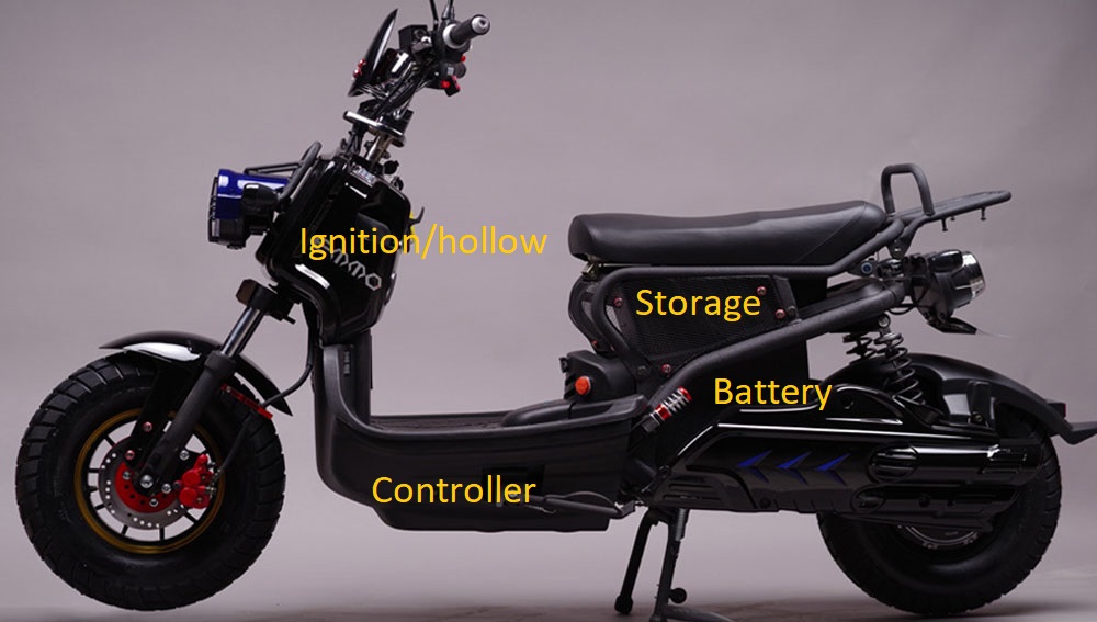

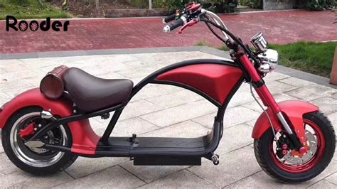

Last season i had a couple of problems on wet roads with the motor controller getting wet and shutting down (yeh, I got to wait until it dried out). Soooo, I want to move it up higher, something like this.
Current configuration is like this
Printing up a couple of brackets and installing the support tube for the "tank" controller box itself is no problem, but I have 2 options for the box itself, I can design and print one which is a YUGE pita and will have to be done in about 8 pieces and glued/screwed together BUT is 100% plastic (PETg probably) so there will never be any short/grounding issues.
#2 is to pick up a used motorcycle gas tank, do a little cutting and printing some trim pieces and using that, but that re-introduces possible moisture issues.
My temporary solution last year was to zip-tie some plastic bags around the unit to waterproof it, and that worked short-term but really isnt a permanent fix.....and besides, with the skull headlight and tail-light, and skeleton hand mirrors, I want a nice rib-cage controller box !!
Both options are about the same work and cost, so which one seems better to you guys ?

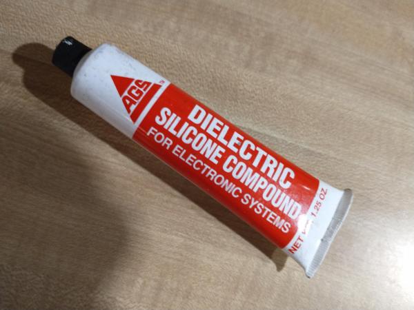

Water proof connections are the key.
Yep.
This is what you need:
