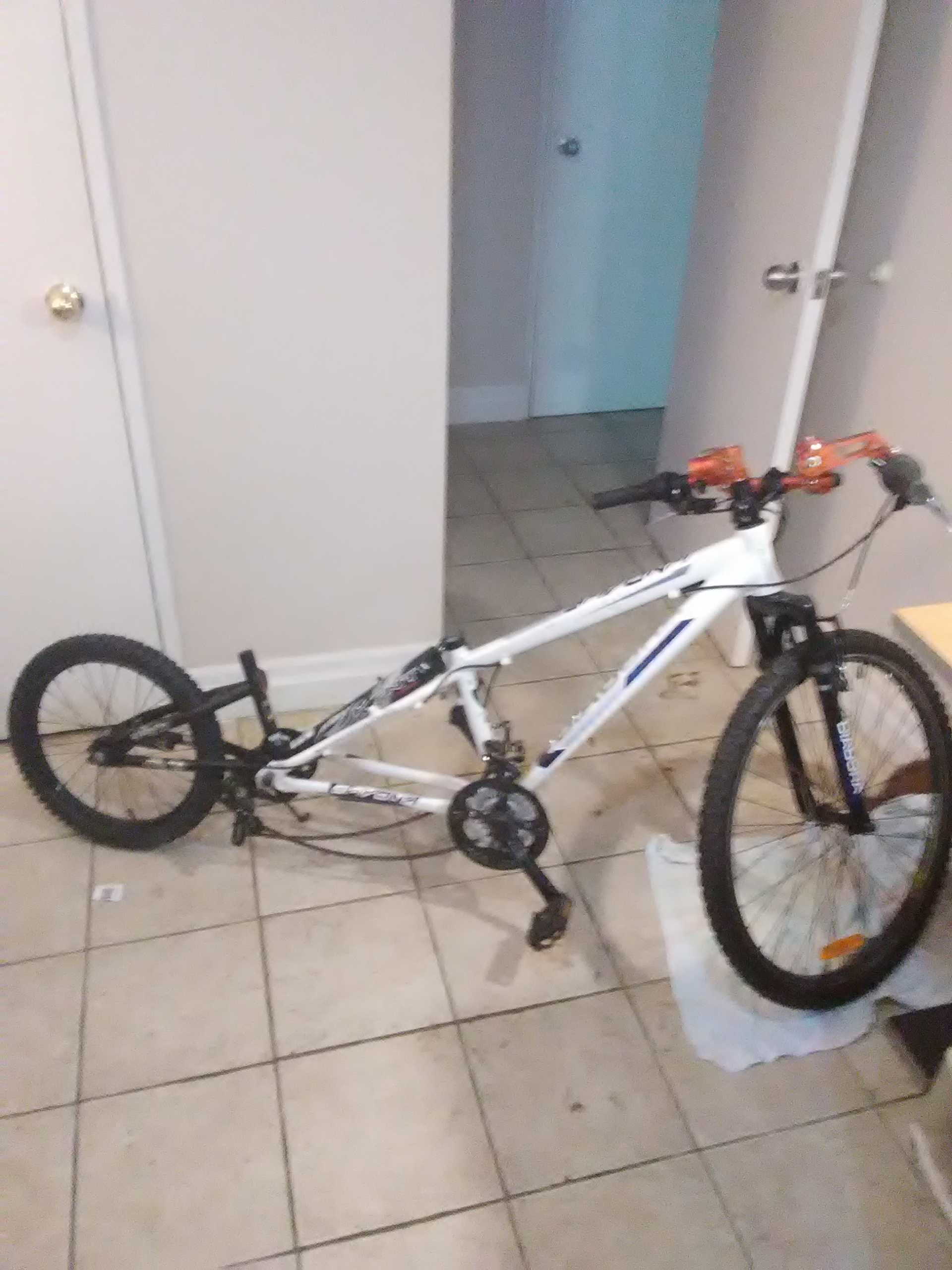

Almost 7 feet long. Next step is a compression brace between the rear seat-post and the front frame. It'll go across the old side-pull brake mounts then back to the post. 16" back wheel and 26 front.

Motorcycle would be called a chopper. Electric ? Meh, they are too new, its still a free-for-all style wise.
Something along the lines of this, but lots longer and lower.
https://www.bikeexif.com/electric-chopper
Still gotta do the final design touches and print the parts, but peddle will both be 45-degree down and forward. Spring back to the frame and a folding lock so they work on a spring-return pump-action, but in reality I dont peddle. They are footrests and retain the peddle-function just to keep the cops off my azz.
Controller box is printed just needs assembly and sanding. Standard motorcycle-style tank with a screaming skull in the front.[This message has been edited by MidEngineManiac (edited 07-20-2022).]

Loads of really nice electric motorcycles out there, but they still need licence and insurance (good luck on finding that last one). And they are still heavy (200+ pounds). Most of the ones you see on the road from ebike dealers are built on ICE motorcycle frames, then peddles are slapped on and the controller power-restricted to keep it legal.
Range is still the main problem. Only way around that is more batteries which is more weight which in turn cuts down the range. Regen braking helps extend it, some guys use solar chargers (not much good for range but does free ya from the grid) or a second motor run as a generator which gets expensive and complicated.
Problem I see a lot on the forums with the home-built conversions is a lot of bicycle frames aren't built to handle the speeds and torque involved in a conversion and they dont last long before breaking without some beefing up. Cruisers or older steel-frame MTB's seem to do OK, it's the newer aluminum-lightweight ones giving problems.[This message has been edited by MidEngineManiac (edited 08-16-2022).]
