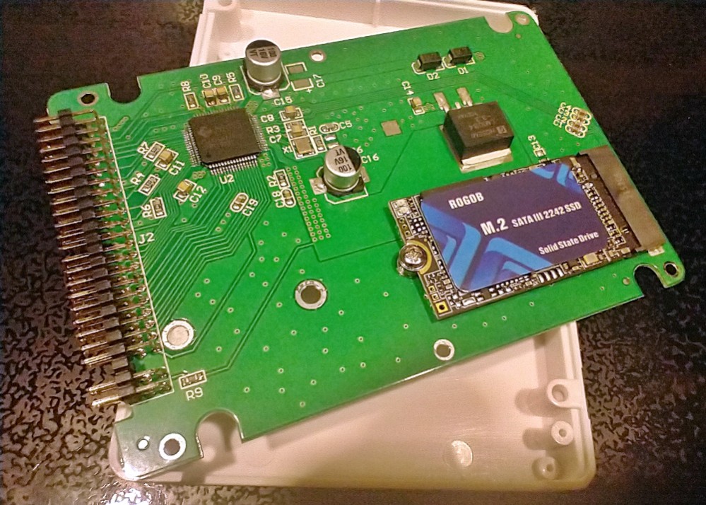

I upgraded my old laptop that I bought around 2006. It came with WinXP, a 40gig IDE drive and 512megs of ram. I found an adapter that takes an M.2 SATA drive and converts it to 44 pin 21/2" IDE, installed a 128gig SSD and 2gigs of RAM.

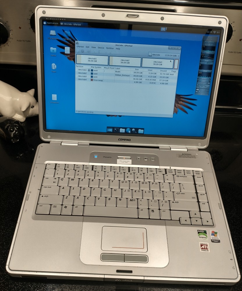

I split the drive into three 40gig partitions and installed two different Linux distros. The third partition is for later experimentation.
Here is the machine running Bodhi Linux with a 4.9 kernel:

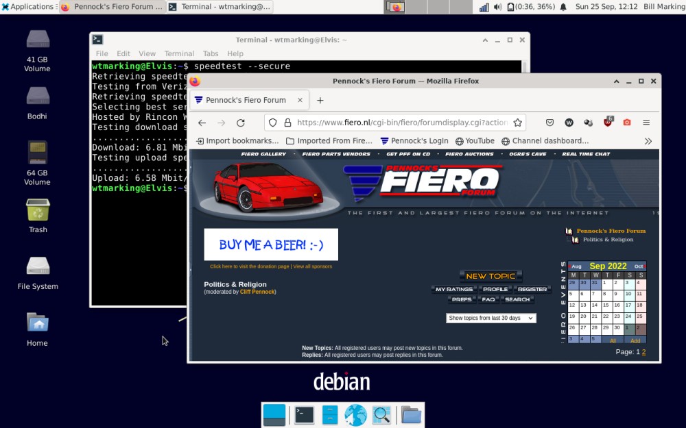

Here is a screenshot with Debian Bullseye and a 5.10 kernel:
Both are XFCE desktop and take around 30 seconds to boot. I am having intermittent problems with the Broadcom wireless adapter on the 5.10 kernel, but it works as expected on the 4.9.
