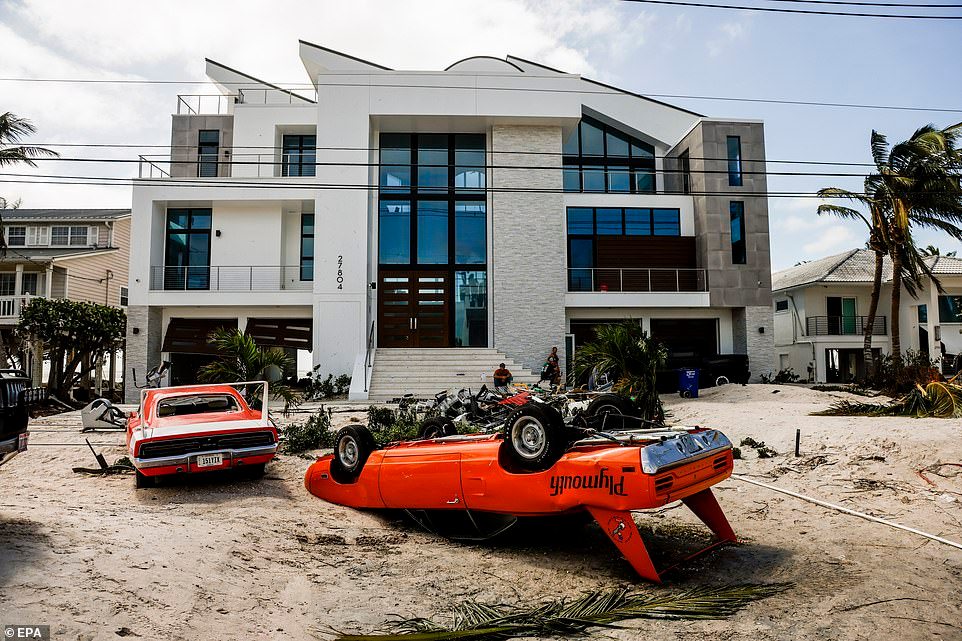

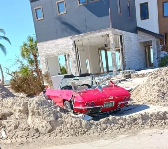

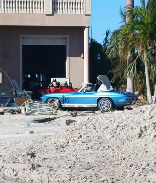

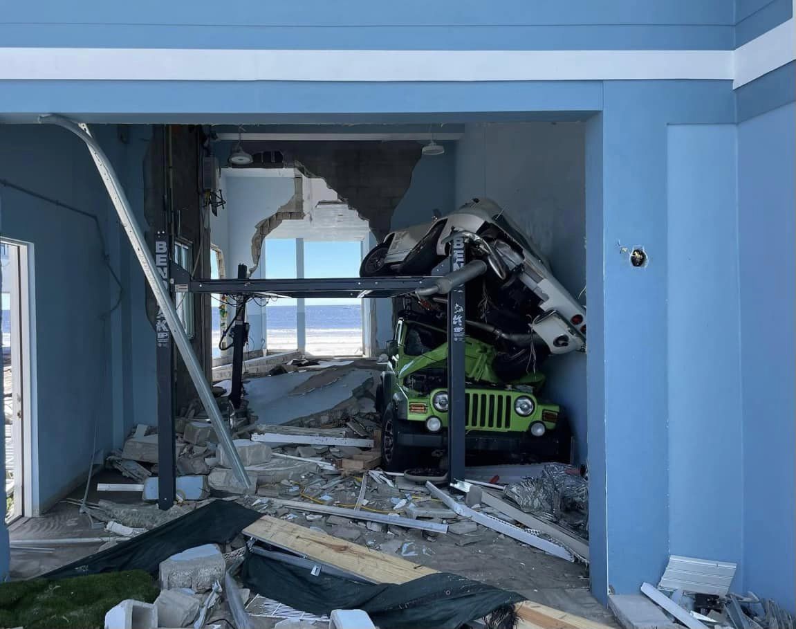

A lot of nice cars used to live in Southwest Florida

Ahh...ahhh...ahhh...
That's buff out.
OMG poor babies....has anybody called yet ? closed the windows and put dehumidifiers in ???
Called for....JESUS CHRIST, they need attention stat !!

I'd think an old distributor ignition car like a vette would salvage just fine, no?
OCT 05, 09:29 AM
quote | Originally posted by Notorio:
I'd think an old distributor ignition car like a vette would salvage just fine, no? |
Still has plug-in connectors. They's all have to be unplugged and cleaned. Remember, this is salt water - and maybe sewage, depending upon where it happened. Both are death on electricals. And if the battery was still connected, any current in the circuits could cause ongoing corrosion.
That's not even considering the effect of the salt on the metal structure. Of course, anything could be cleaned/washed, but you're talking about a major rebuild. Would only be financially worthwhile for high dollar stuff like Vettes and the Superbirds. I might attempt to rebuild a Fiero, but only because I know them so well, and because they have a minimum of electronics - all of which are replaceable.[This message has been edited by Raydar (edited 10-05-2022).]

You can't really "replace" those cars, so I'm sure most of those will get restored. I'd guarantee that all of them were covered by collector car insurance... and Haggerty's is pretty good. Wouldn't be surprised if all four of them were. They'll get fixed.
