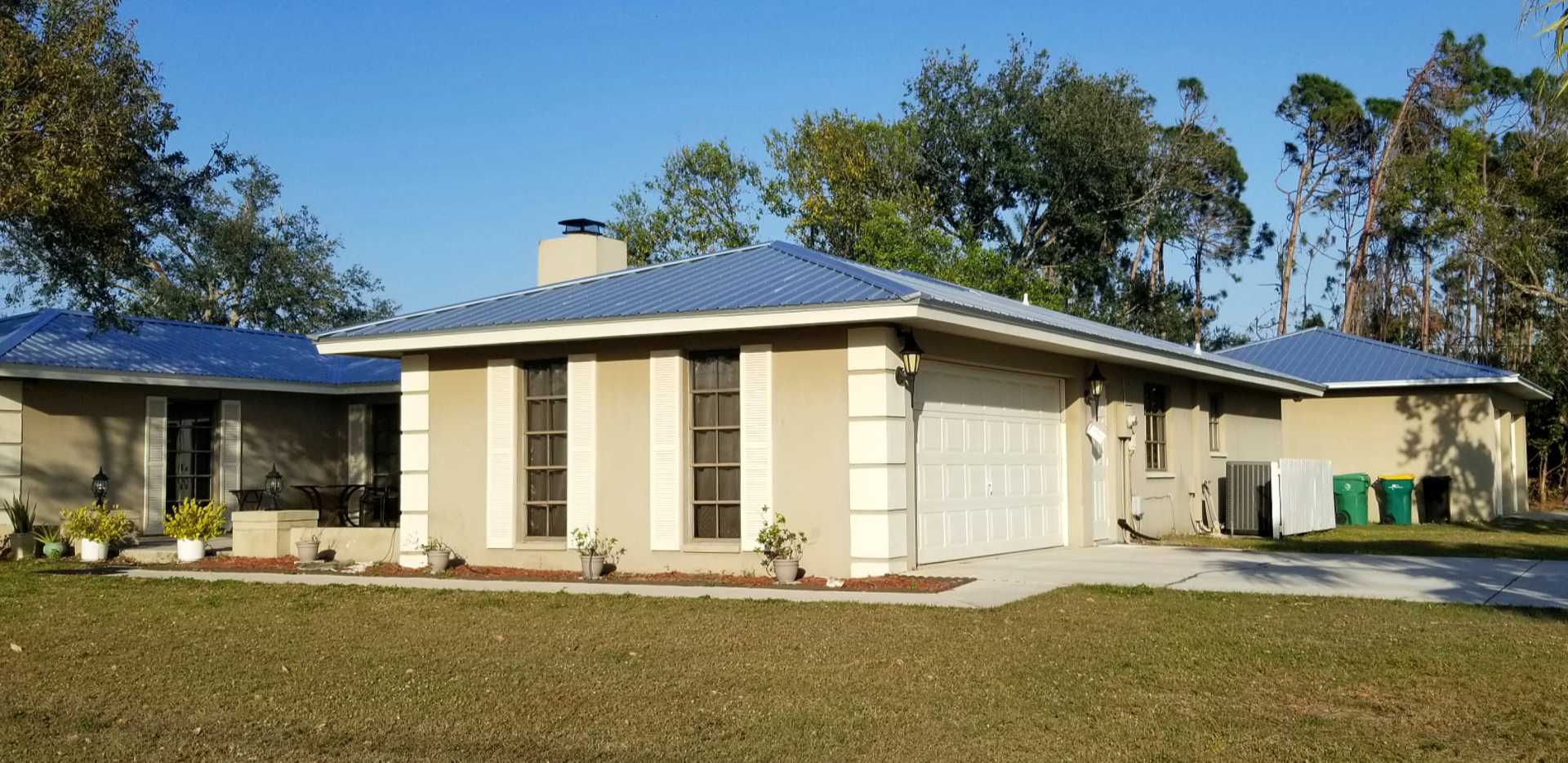

Completed most repairs from Hurricane Ian.

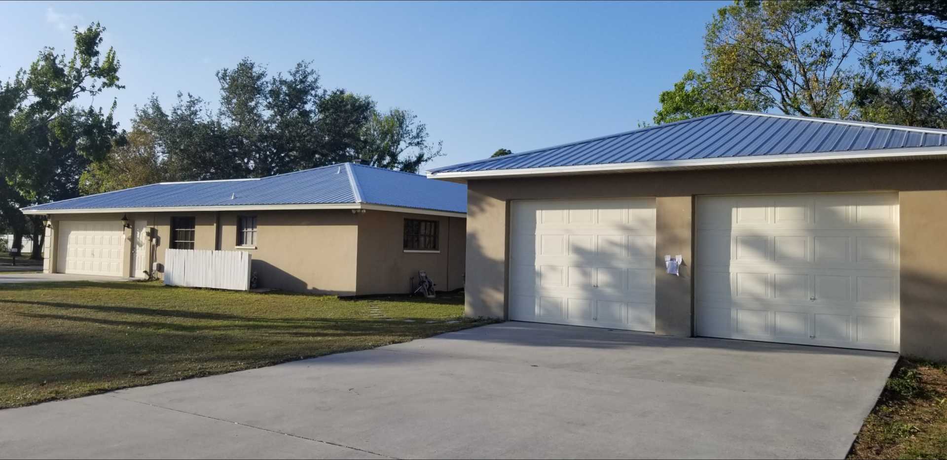

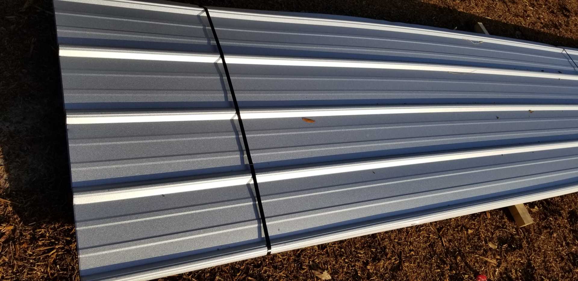

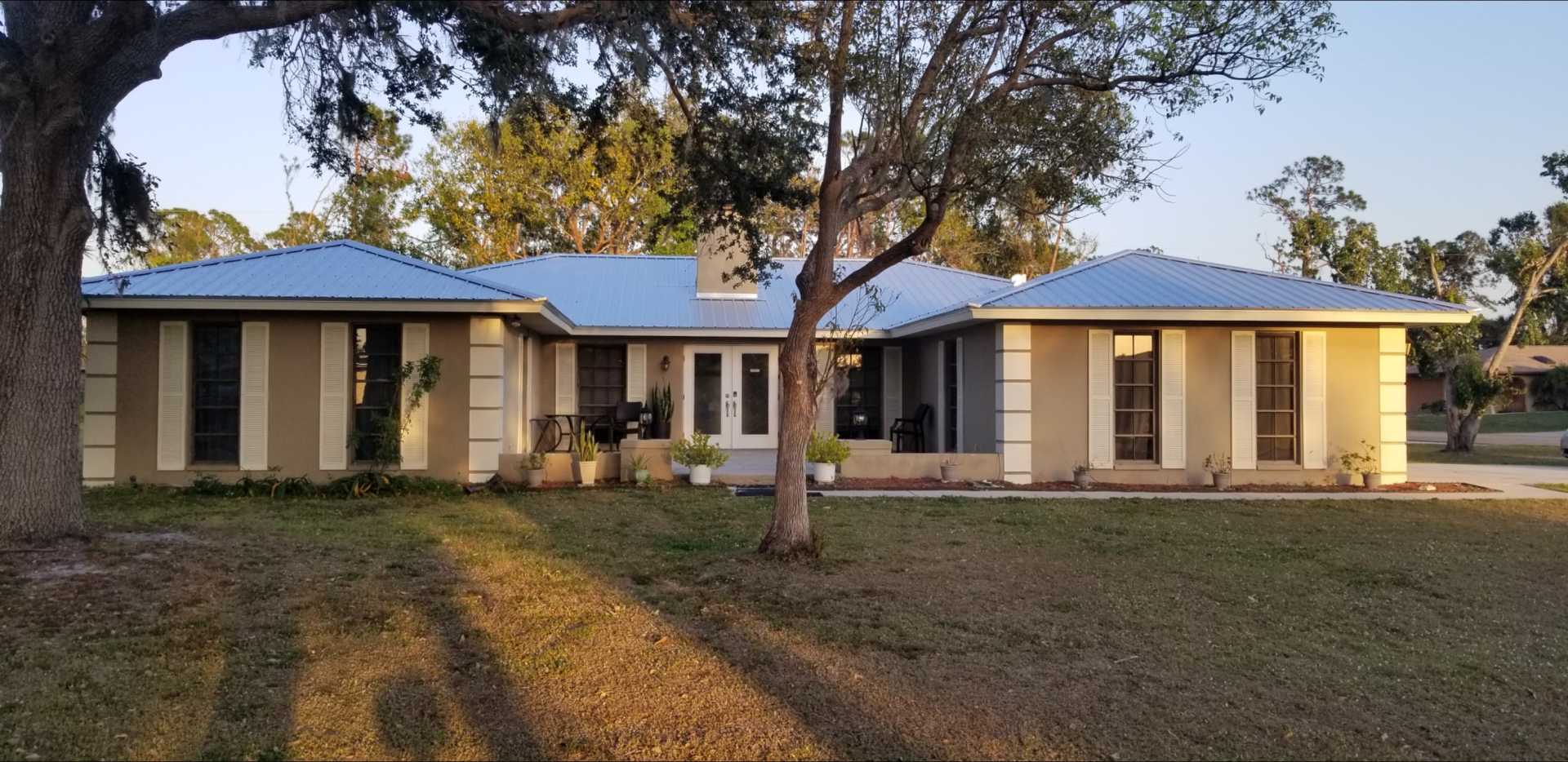

Replaced roof on both structures. Went with metal instead of shingles.

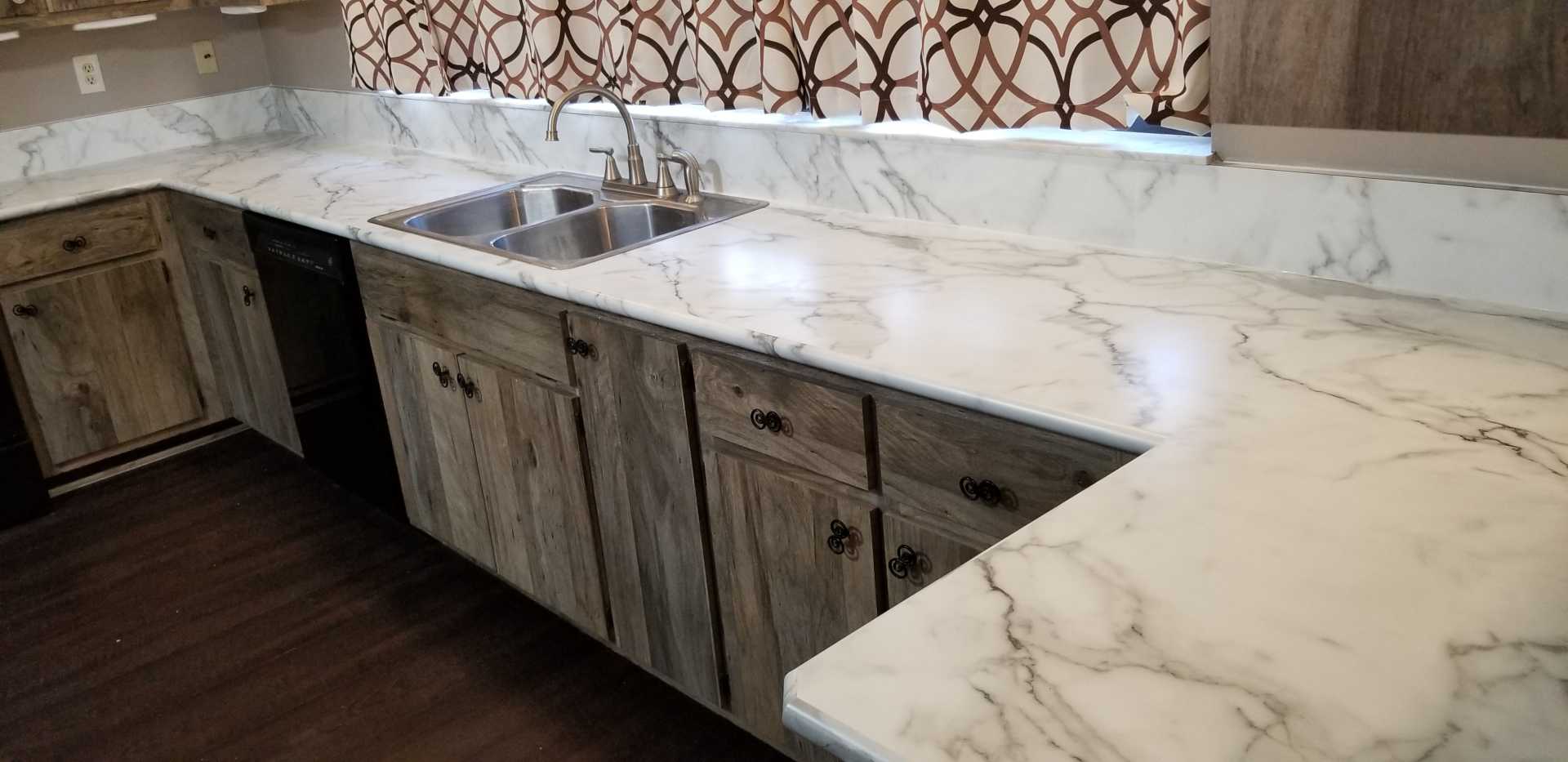

Replaced kitchen countertops.

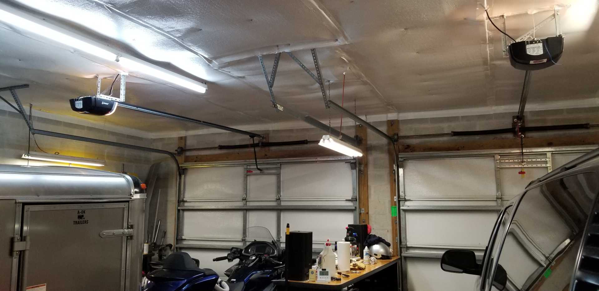

Replaced the garage ceiling.
Cut down four trees - two of which came down on the garage, did not cause any damage.
The contractor will be installing 6 " wrap around gutters on the house next week.
Have a few short term projects, replace small 12' long fence, install outdoor tile on courtyard.

Looks good, I wanted to go metal at one of my houses and the county said now.
Did it come sealed or did you do it after?

Was sealed before. The material is 5V Galvaume Gulf rib 26 gauge. Came in 20' long sheets.
After both hurricanes most of the metal roofs did a lot better than shingle roofs.
