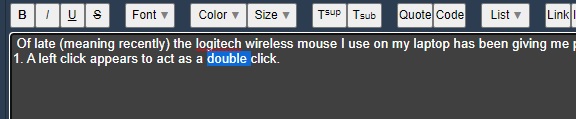

Of late (meaning recently) the logitech wireless mouse I use on my laptop has been giving me problems.
1. A left click appears to act as a double click. It often (but not always) highlights an entire word or even a whole sentence instead of just moving the cursor. I just left clicked on the word 'double' and it highlighted it instead of moving the cursor to between the letter 'o' and 'u'.

I had the exact same issue with 2 of my Logitech marble mice and yes, it was the left button or it's circuit board. It would double click at random and got worse over the following weeks. If I used the scroll bar on the right of the screen and accidentally hover over the "x", it would close the web page. VERY annoying. I replaced it and have zero issues now.
