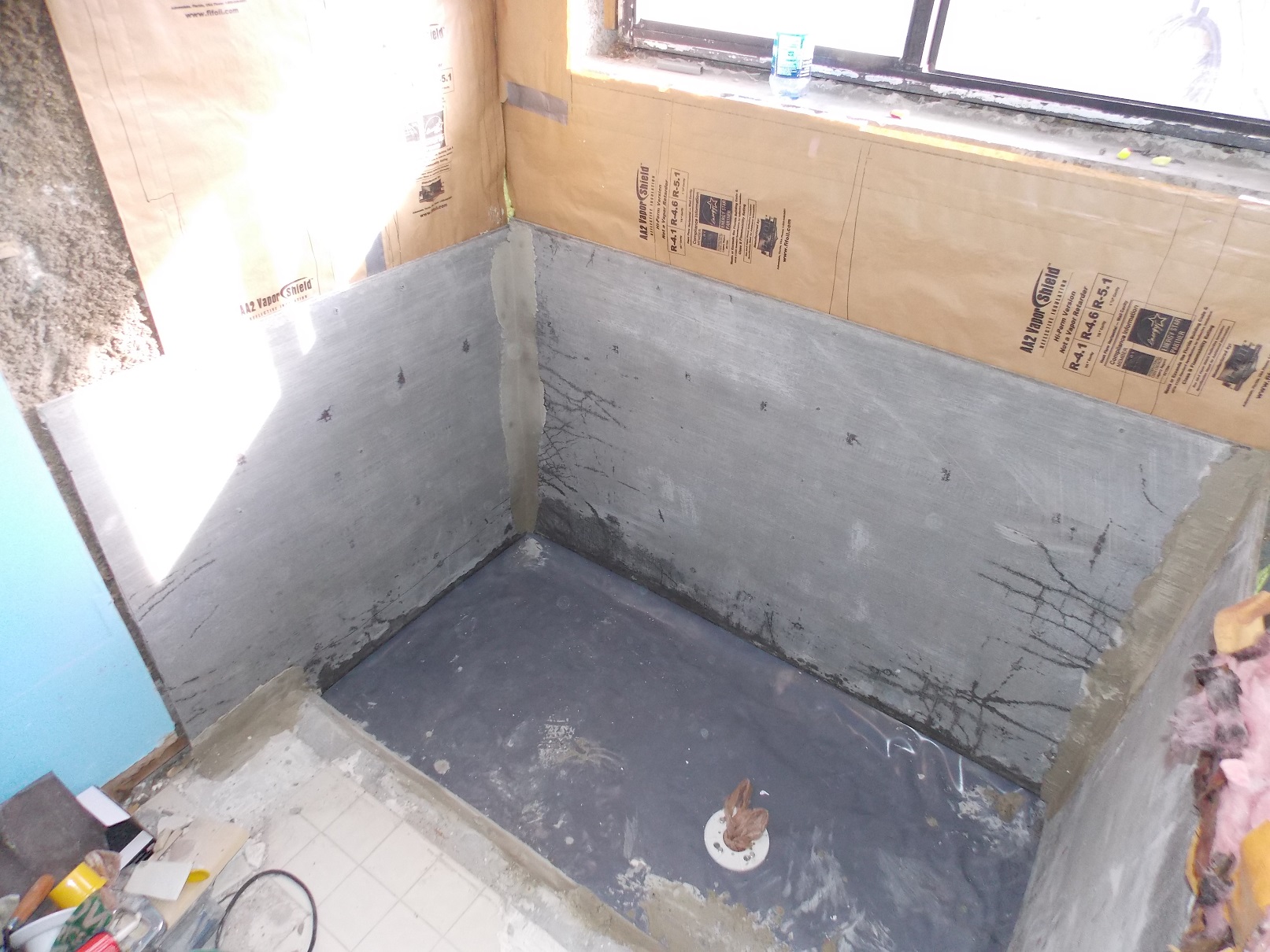

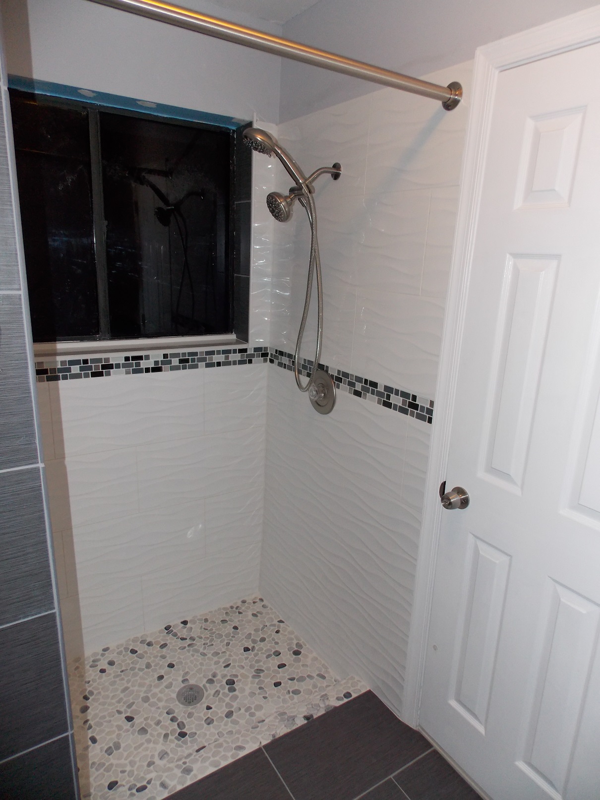

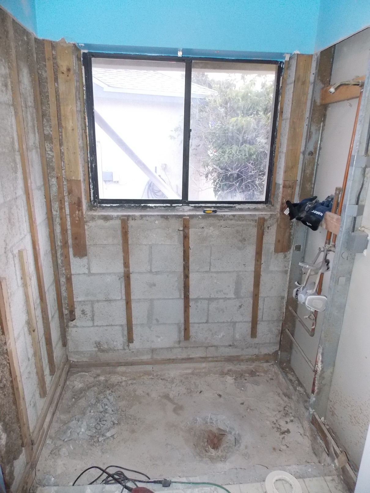

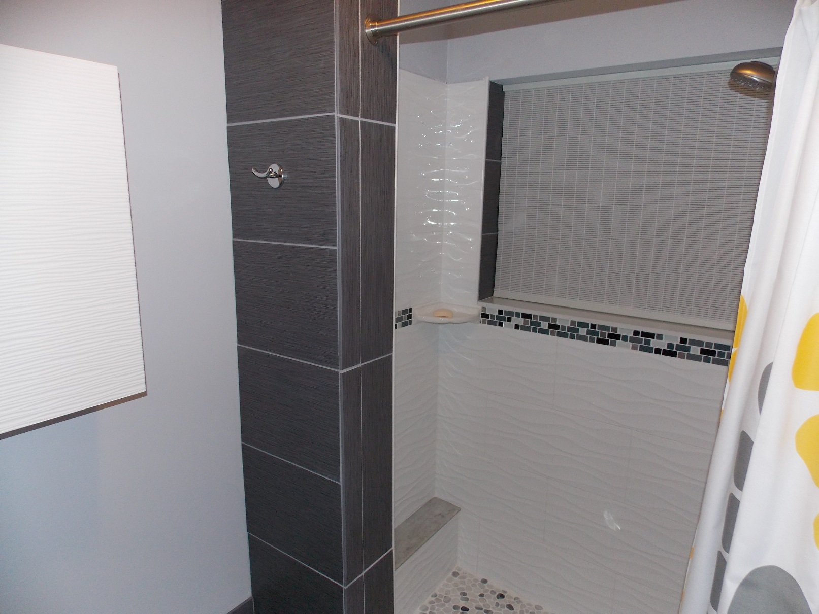

Ok... I've completely re-done two showers in my life. Both of them were on the ground floor, and with a concrete slab underneath.
Here's the first one I did...
started like this:
Ended like this:
 (almost done in this pic, just needed some more trim work, etc.)
... and officially done in this picture:
... in both cases though, I used one of these... a rubber liner on top of an already existing concrete slab, and then poured more concrete on top of that so I'd have a substrate to put tile down on...
