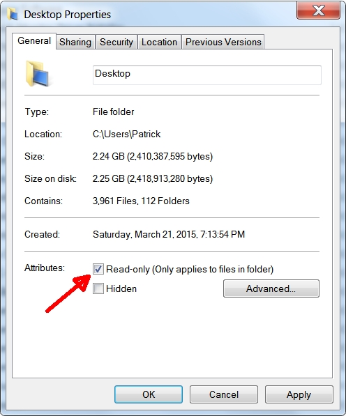

APR 30, 04:16 PM
Right click on your Desktop folder in Explorer. Make sure there isn't a tick in the box indicated.
otakudude
APR 30, 04:52 PM
Right click on your Desktop folder in Explorer. Make sure there isn't a tick in the box indicated. |
Good thought but unfortunately that wasn't the case. Ah well, I should have guessed that the fix wasn't going to be that easy. lol[This message has been edited by otakudude (edited 04-30-2024).]
