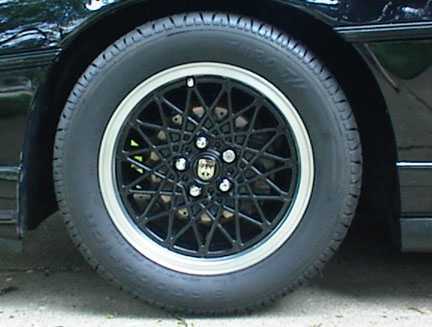

I am running BFGoodrich Euro T/A's. They are all 225/50HR15's on GT wheels. The 225/50-15's are perfect for 15X7" GT wheels. The recommended wheel size for these tires per BFG is 6" to 8". I even have my car lowered and stiffened up the suspension. There is no rubbing and very little tire roll. The car handles great! I did a lot of research for my tires, I was originally going to go with 245/50-15's all the way around. You need to be less than 1" overhang from the wheel. So a 9" wide tire should be max width for a 7" wheel. The BFG 225/50-15's are 8.8" wide with a 4.4" sidewall. Your speedo will be 1.8% faster than true speed due to the overall size of the tire. Here is a pic of my front tire.
Pretender ~ are you sure the tire is a 50 series and not a 60 series? You say it fills the wheel well up. Is your car lowered or stock suspension?
