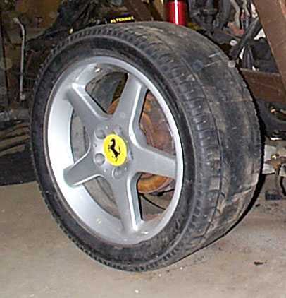

Hi all, I'm new to this forum, but hope to be able to add as needed. I am currently building a Ferrari 308/328 replica Ferrari and may periodically drop a few questions if anyone else has any experience with these kits. I am building the kit on my 85 Fiero (95 ETC Cadillac Northstar) and would also love to discuss power upgrades for the Northstar conversion in the Fiero.
My question of the moment, however, deals with the availability of replica wheels. I have only found one source which even looks close (compomotive ts) and they are about $2000 for the set (+tires). Does anyone else know a good source?
At this price, it seems like I may luck into a bargain on some real ferrari rims (one set recently went on ebay for $400, but I missed the pics. If something like this came about, what would I have to do to get them to work (I am planning on a brake upgrade anyway and have a Koni/Eibach suspension setup.

HRE makes a Ferrari replica 3 piece wheel available on the 328GTS quattrovalve. https://www.fiero.nl/forum/Forum4/HTML/001175.html they are available in 15-18" with 38-45mm offsets. i'm not sure about a price though! welcome to the forum.. Compo' makes nice stuff! but they are pricey... you check out Fikse yet? www.fikse.com or Enkei? they make Ferrari custom wheels also... www.enkei.com hmm.. hope this helps a bit. as for go fast stuff. you need 2 turbonetics T-04 super 60s. www.turboneticsinc.com !! 500+ at the wheels off one of their customers STSs with 12psi!

I also passed on the Compomotive rims for my Lambo replica, way out of range! I don't know of any other source for replica wheels, but I have seen some go cheap on Ebay, the last ones I remember were from a Mondial. My rossa is getting 17" Kosei 5SRs with genuine Ferrari caps. You can make almost any wheel fit using billet adapters. They are a minimum of 1" thick and can be made to your specs. The only thing you have to watch is offset and caliper clearance.

Ok, here are a couple of wheels, I think would look great on that car, and the price is Great. They are more updated and you can get them in 17". They are at JD Wheels: http://www.jdwheels.com
This is a copy of the Speedline wheel made by Eagle Alloy 077:
Or you can use the one like on the 355s, Roh ZS wheels:
On the wheel adapters, the thing people had problems with were the wheel “spacers” that fit in between the wheel and the hub like a washer. The spacer/adapter actually bolts up to the hub and then the wheel bolts up to the adapter.
You can get wheel adapters from http://www.wheeladapters.com/ the old guy there is Fred, and he is great to talk to and work with.

I bought my Wheel adapters for the Countach from Fred at the link that Spyder posted above. I called to order them, and we ended up talking for about 30 minutes! Really nice guy. Make sure you don't get cast adapters. I had a set of cast aluminum adapters and they wobbled like hell. I swapped them out for a set of Fred's machined ones and never had another problem. It would be easy to make the OEM Ferrari wheels fit, but depending on offset, they might hang out too far. My car will need adapters on the rear that are about 3" wide, even though I widened the rear track.

Ferrari F-355 17X7 (front) & 17X9.5 (rear) WILL fit with coil-over's in the rear the bolt pattern is 5X100mm My frined's dad has a set that he's putting on it F-355 Spyder kit car i think it is a wide body kit though but so is a 308 right?
