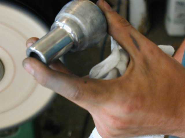

I made my own knob on our lathe out of aluminum, and polished it up. I was going to thread it, but had a hard time figuring out the thread. None of the metric nuts at work would fit it. Since then, I dont use the knob anymore, and I also got a full metric tap and die set. I will go out tomorrow and check the pitch after work and post it here if someone else hasnt yet.
anyway, here is a pic of the knob I made...this is before I polished it (only pic I got right now)

Looks good. I'd like to know the size and pitch of the threads, too. Maybe I'll have to find a decent shop around here to make me a knob.

FieroJoe, that is a cool shift knob.
