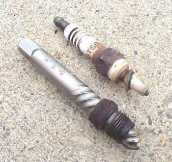

Problem: I was changing the spark plugs on my 2.5L 4 cyl. today, one of the plugs the previous owner installed had rusted at the base. It weaken the metal enough that it wrenched right off leaving the lower portion of the plug still in the head!
Solution: First, stomp, shout, and rant & rave for a few minutes. Once I got that out of my system, I soaked up the threads with liquid wrench because it took almost no force to snap the plug, wasn't sure if the plug was frozen in the head. Next, used an EZ-out to back the plug out of the head. I was fearing the EZ-out would break the electrode off in the cylinder, pretty scary moments trying to think of the best approach. One wrong move, and your outa luck. Anyway, went with the EZ-out and used a pipe on the wrench. Gave it about a dozen or so quick tugs and the plug started to back out! Woo Hoo! Did the electrode snap off? NO, *phew* Yea, HOO!
Here's a picture of the plug:
Preventative maintenance for the 2.5L guys. Use anti-seize or grease on the plug threads and metal socket portion. By design, water likes to sit around the plugs and corrode them. If the previous owner had greased those puppies, I wouldn't have had as much fun today.

Yea, where it broke, the edge is paper thin. Looking at it closer, it almost looks like it might have started to leak in a spot.

The top of the metal part rolls over the ceramic and is quite thin there. The vent is right over the engine in the '84 and rain water sits in the plug wells where it rusts the plugs.
I was driving down the road when the entire ceramic part was shot out the top of the plug. Talk about a lot of noise and rough engine. The ceramic was still in the plug wire. The metal was still in the block. Hex part just twisted off like you saw. I used the ez out just as you did and it worked too.
