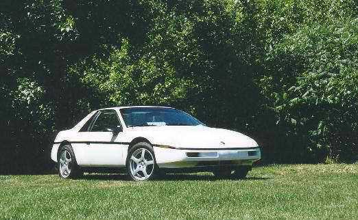

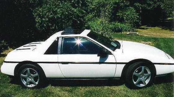

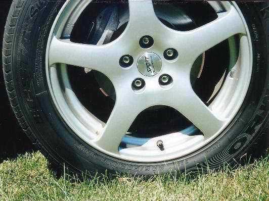

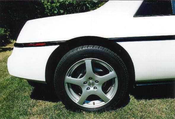

This summer I put on a nice set of 16's. I bought 16X7 Sport Edition Valores. Also 225/50ZR16 Kumho Escta Supras tires on the rear and 205/55ZR16 front. This gives me a really firm ride, not to bumpy. Handeling is incredable with this set up. I was somewhat on a budget, it seems like it wound have cost like another 400 at least to get 17's. Everything total was 820$ shiped to my door from tirerack. I also bought my snow tires from them . My snows are obviously are crap tires but are good for winter and fun to abuse :P.
Ill attach a few pictures, I think the 16s really look nice myself...
