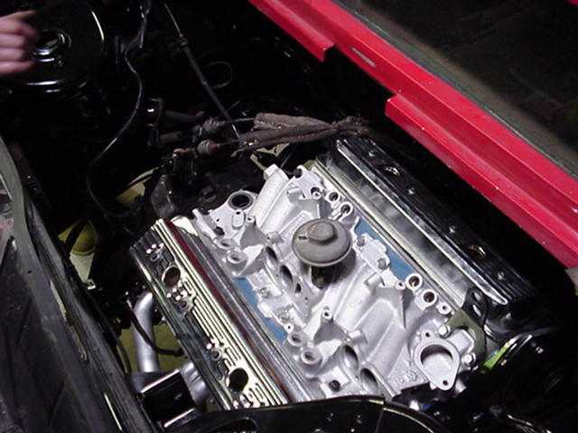

I'm going to cover this V-8 swap on a day by day basis. The last V-8 swap I showed you was done "live" in that I posted progress everyday. I did that not knowing how close to schedule we would be or exactly how it would come out. I really knew it would come out good, I just didn't know how much or little "flogging" we would have to do to get it perfect. This swap has already been completed and the customer has been driving the car for about a month. He drove the car to Chicago with a 2.8 Turbo engine in it and drove it back to Napa, CA with the new engine in it. While we did his swap, he was here in Chicago visiting relatives and watching us do the V-8 swap. During that time I introduced him to PFF and he became a new member as a result. For now I'm only going to use his 1st name, Bob. He can introduce himself to you as he sees fit.
So, I'm going to report this swap to you daily as if in real time. This swap is a ZZ4 Chevy crate engine with TPI into a 1985 Fiero GT 4 speed with a Corson "Boxer" body kit on it. We actually started this swap one day before the customer arrived with his car. You see we wanted to get him back on the road home within 10 days and since we had the engine at the shop, we did a bunch of the work to the engine the day before he arrived. We started working on his engine on 9-10-01 & as it turned out he arrived on 9-11-01. Needless to say, with the insanity of 9-11, we did not work on his car that day.

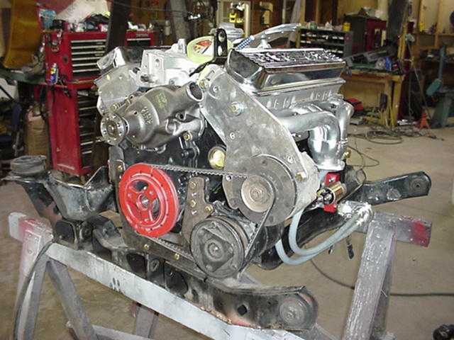

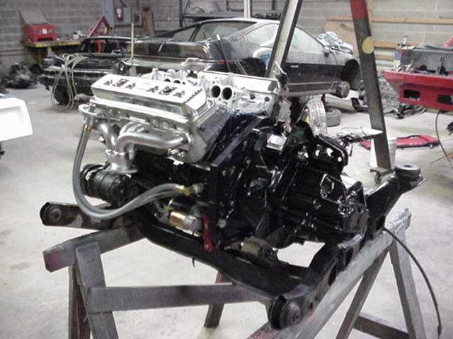

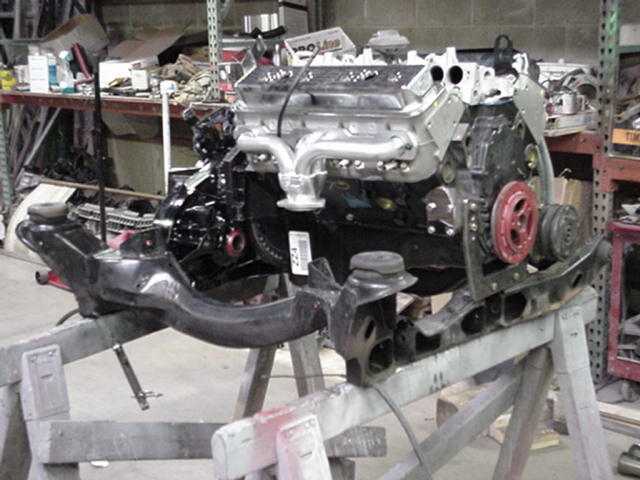

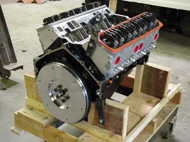

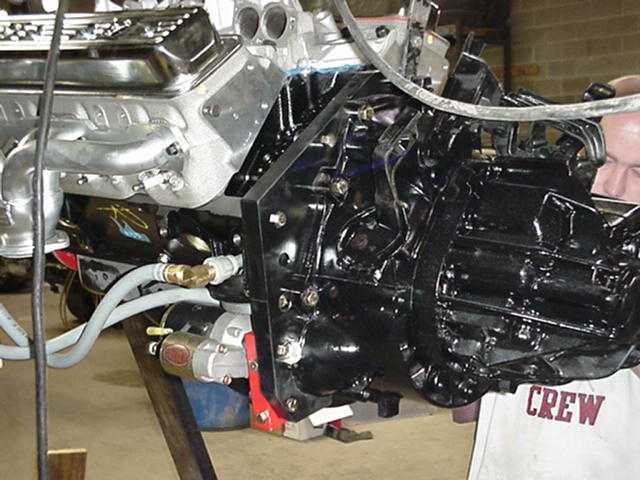

Day #1 9-10-01… With the ZZ4 engine still sitting in it's crate we removed the black valve covers, water pump, original HBP & intake…. The valve covers will be replaced with chrome ones and everything else will be replaced with items I will be supplying. A lot of pre-assembly work can be done on the engine before you need the Fiero taken apart. Let's look…

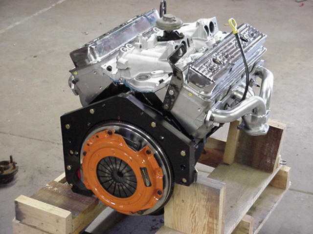

Here is what it looks like naked with just our Flywheel bolted on.

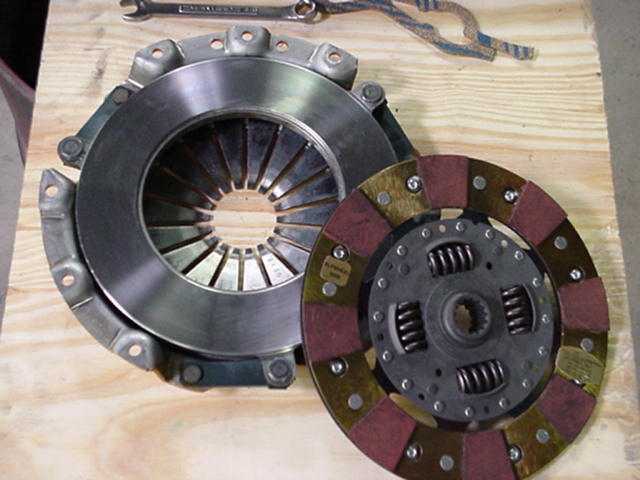

Our CenterForce clutch.

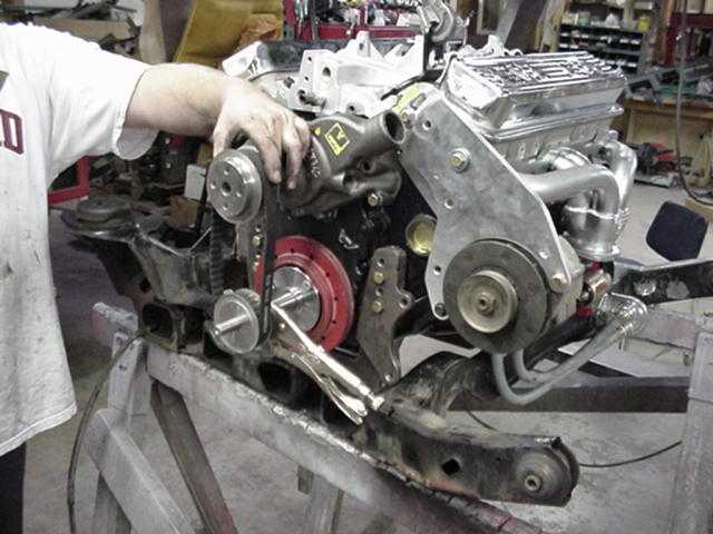

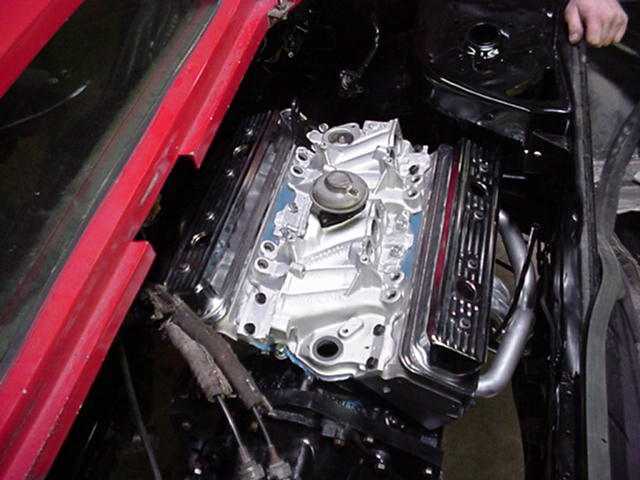

The TPI base intake manifold, Chrome Valve covers, Clutch, headers & Engine/Transmission adapter plate installed.

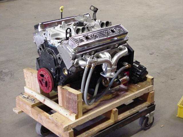

The Starter, Remote Oil Filter, HBP & even the dipstick can be installed to the engine.

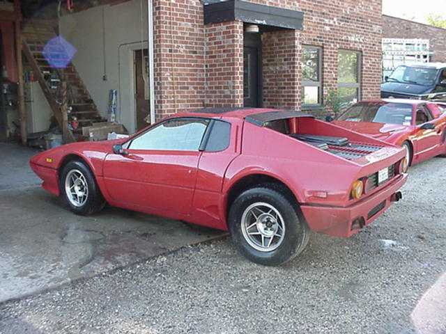

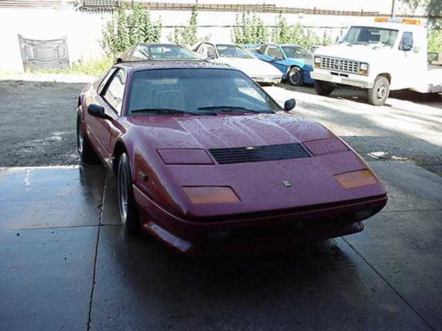

The victim arrives…..
Welcome, come on in, you'll never be the same.
Tomorrow, we do the nasty job of taking the thing apart.

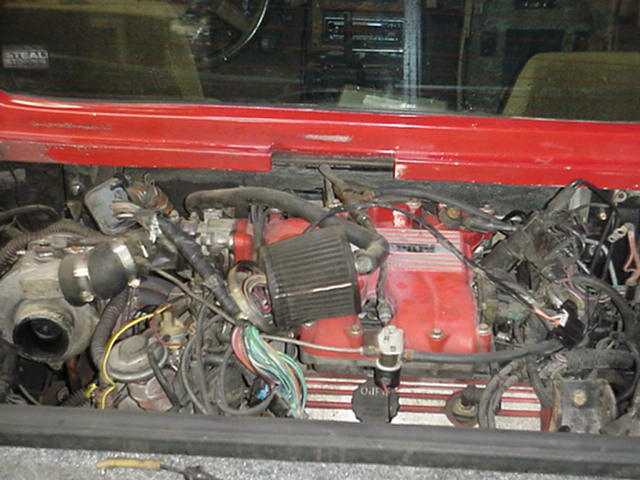

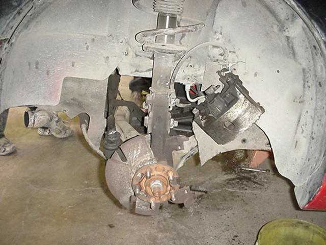

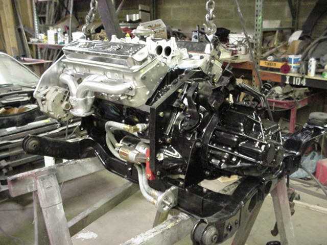

Day #2 9-12-01…

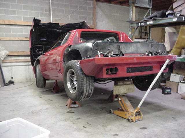

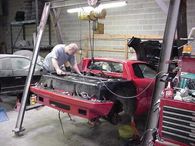

Day #2 finds us taking out the old Fiero Engine, this is probably the worst part of the whole process. You always run into the unknown history of your Fiero here. This car was from the SouthWest and was also well maintained and was easier to dis-assemble than most 16 year old Fieros I've seen. Good deal for us, there are no frozen or stripped bolts on this car.
We've removed the Rear clip of the Corson body kit and started removing all the items we can reach from the top. It's easier to remove this stuff now while the car is still on the floor. We can remove the throttle and cruise cables, battery, dog bone, air cleaner, coolant & heater hoses etc. The slave cylinder has been removed from it's bracket on the transmission but has been left connected to the hyd. Line & tied up out of the way. The wire harness has been disconnected from the ECM and laid on top of the engine. We removed the inside console to get to and disconnect the harness from the ECM.

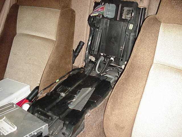

It is easier to remove the harness, undamaged, from the engine once we get the assembly out of the car.

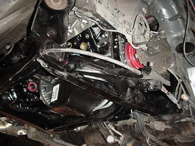

Now we'll get the car up in the air and remove/disconnect items from underneath. This car has a good fully charged & operational A/C system so we don't remove the A/C compressor with the engine. Instead we will be leaving it in the car and fitting it to the new engine during one of the trial fit sessions.
When we remove the engine/cradle assembly, we will also be removing the suspension system with it. Here we remove the calipers from the spindles and hang them safely out of the way.

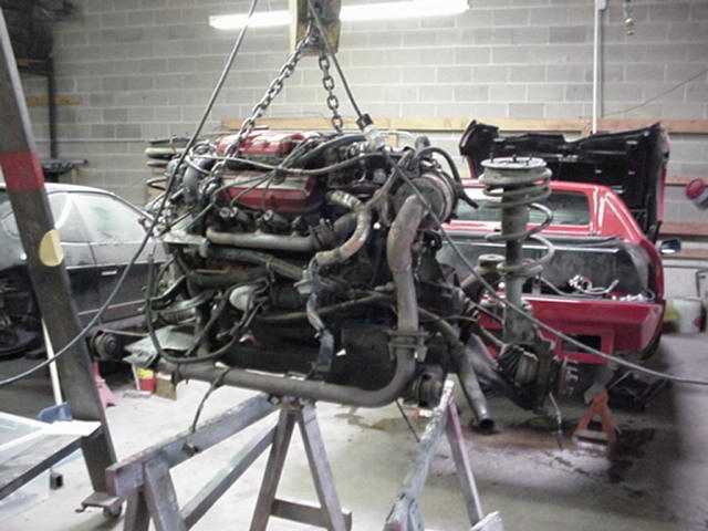

With the car up on the jackstands, we connect the overhead hoist for support and get ready to lower the assembly out of the car.

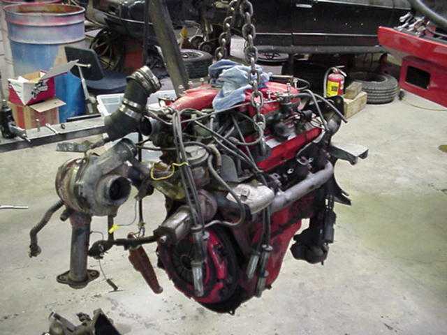

Here is the whole thing out of the car. We can now remove the exhaust system, the wire harness & the suspension. We then can remove the engine/transmission assy. From the cradle then remove the transmission from the engine.
This is the "Extra" parts we have to get rid of.
Then we get to clean, prep & paint the engine compartment and engine cradle & clean and paint the original 4 speed transmission.
Tomorrow, we get to go back to the fun part of putting together all the nice new clean parts that we've gathered together for this engine swap.
We'll see you then…….

Day #2 9-13-01…
Alright, this is where the fun part begins. We have a nice big collection of some of the best parts you can get your hands on & now we get to play with them.
Here we've bolted the engine & transmission together and are about to set them on the engine cradle for the 1st time.
With the engine/trans. Assembly mounted to the engine cradle we can begin to fit all the other parts to complete this assembly. You'll notice that we are doing all this while the assy. is setting up on a pair of sawhorses. This is one of the things I like most about working on these Fiero engine swaps. On most engine swaps to other kinds of cars, you spend hours laying under the car or hanging over the fenders. On a Fiero V-8 swap, you spend maybe an hour under the car and another 2 hours reaching over the fender & you're done. Most of the time you spend on a Fiero V-8 swap you spend walking around and working on your engine/trans./cradle assy. Sitting up here on your "workbench" (sawhorses).
The HBP, Alternator and A/C compressor are mounted & the W/Pump is temporarily mounted so that we can trial fit the W/P drive. Also notice that we've mounted the remote oil filter mount to the engine cradle.
Here is the trial fit of the W/P drive. Yeap, this is the belt drive system that all those experts say won't work. Some people have used electric W/Pumps, which eliminates this setup.
All painted and pretty, she's all ready to go into the car for a trial fit.
Yes, a trial fit, even after doing all these V-8 swaps I still do trial fits, it only takes maybe 30 minutes to do a proper trial fit and I like EVERYTHING to be just right.

Ok i'll try to ask a few intelligent questions now. I see that you have an A/C compressor mounted to the engine but I thought you were leaving that attached to the car since the A/C had a good charge. Just wondering if there is a purpose for that. Also I am wondering about tensioning the belts. How does the belt that runs the alternator and compressor get tensioned. It looks as if the alternator is bolted solid to the bracket. Does the compressor move? Last question. Does the W/P belt need tensioned? If so how and if not why not?
Thanks
Archie
Posts: 9436
From: Las Vegas, NV
Registered: Dec 1999
Total ratings: 547
Report this Post10-29-2001 10:14 AM Click Here to See the Profile for ArchieClick Here to visit Archie's HomePageSend a Private Message to ArchieDirect Link to This Post
Thanks
Good questions.....The A/C compressor that we are using for this fitting is an extra one that I have laying around for trial fitting only. In this case we need to get the V belt aligned, so we use this extra Compressor for that purpose only. When we put the engine in for the last time we will leave this one off and mount the one that is still in the car once we get the engine in.
Tensioning the belts.... You'll notice that the alternator bracket that is bolted to the cylinder head and that it has a "Slot" at one of the mounting points. We use that slot to tension the belt.
The Water Pump belt is a cogged belt and it is not tensioned, the cogs will keep it from slipping.
Other questions that have been asked.....
Sage, yes we do power wash the cradle, transmission etc. and we use a good black enamal paint. In 99% of these swaps (if it's not damaged) we can & do use the stock throttle cable.
Orville, When I said "from what they've told me you need a production engine," I ment to say that the requirements are dictated by your engine choice. The term "production engine" means either a crate engine that was designated for a production vehicle or an engine removed from a production vehicle. In other words, I agree with your statement pertaining with this subject.
I hope this helps.

Archie,
Quick question for ya,
With the use of your adapter plate does this affect the throw of the clutch?
To elaborate a little here incase that's not the right term.
The clutch and pressure plate are bolted to the engine.
The throw bearing pushes the pressure plate.
Doesn't the adapter lengthen the distance that bearing has to travel? or is there enough play in the distance that these bearings can travel?
Or is the distance compensated with a combination of pressure plate and bearing you use?
If any of this (or all ) doesn't make sense, please let me know Ill explain it differently.
If anyone else knows what I am saying but could explain it properly .. please do.
Again thanx for doing these threads, they are extremely informative and fun to follow

Originally posted by Hippocrat:
Archie,
I understand your Question & it's a good one.
You are correct the adapter plate thickness would change the dynamics of the clutch. So when I designed my kit I custom designed the Flywheel to actually extend into the Fiero bellhousing. In other words with my F/W & adapter plate, the clutch surface of the Flywheel is the same depth into the Fiero bellhousing as the original Fiero unit was. That way all the clutch linkage etc. is the same.

Day #4… 9-14-01
As you can see there is quite a bit of room on both the front and rear sides of the engine. I've measured it and found that the total width of the Chevy engine with the exhaust manifolds on it is an inch narrower that the Fiero 2.8 with the Fiero exhaust manifolds on it.
Now this is the first view of the underside of the assembly in the Fiero. Now remember that this is a trial fit….. the whole assembly will be removed from the car and final cleaning, painting and assembly will be done before it is re-installed into the Fiero for the last time.
Note because of a disc problem, I've had to make a few of these pics from video tape.
After final assy. The engine cradle assy. Is ready to reinstall into the Fiero.
The engine compartment was also cleaned and painted.
We are putting the cradle assembly back into the Fiero for the last time.
Next, we will be doing the assy. Of the injection and wiring.
Stay tuned.
