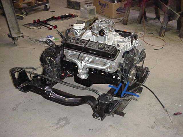

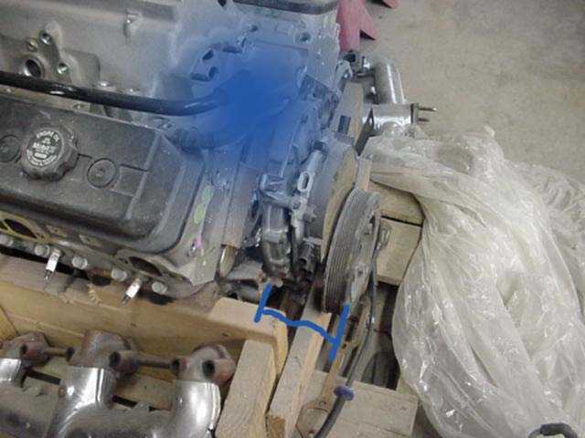

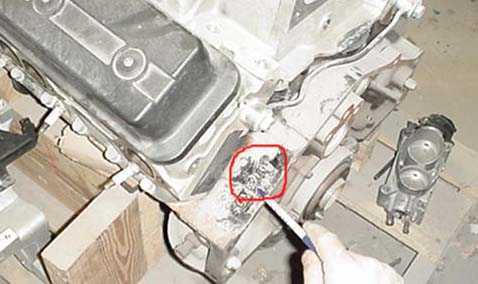

#1 ... The reason the engine MUST be moved 2" is because of the water pump!!! It is driven off the cam and HAS to be used.
Second ... make SURE the engine out of the Buick is a LT1 engine!!! And not the Y99 (?) which looks exactly like the LT1 BUT is only a 4.3 V8!!!!!! (265 ci)
I have a friend building a street rod and got one of the Y99(?) engines by expensive mistake ... NO ONE wants the 4.3L version. They were used in lots of Police cars and my friend thought that if it was in a Police car, it would be the LT1! WRONG!
I believe the VIN character for the small engine is "D" but I'm trying to remember back ~ 6+ months ago when I heard his tale of woe.
One thing about the aluminum LT1 heads ... they are cheap! I bought a set by mistake (thought they were L98 (TPI) heads ... almost couldn't give them away! They go for < $300 all the time on eBay.

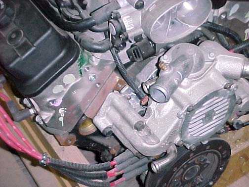

Regarding the Roadmaster and other full size RWD GM cars that have the LT1's. As you've been told some of them are 4.3 Liter V-8 engines. Many people see the LT1 top end on the engine and assume that it's a 350 (5.7L) engine. The only way you can know for sure is to inspect the engine block. Back on the rear of the engine behind the left cyl. head the engine size is cast into the block. See picture below, in that area it will tell you if it's a 4.3 or a 5.7 engine.
Difference between LT1 & TPI (this will also answer some of the other questions that have been asked).... Let me add this to what has already been said. A TPI engine is based on a "normal" SBC engine. WHAT do I mean by "normal"?? When the LT1 came out, it was the first SBC engine that had the distributor mounted on the end of the crankshaft rather than in the top of the intake manifold & it was the first SBC to use a cam driven waterpump instead of the belt driven waterpumps. Because of it's external appearance somepeople think that the LT1 has an electric waterpump, but actually it's driven from the back side by a shaft from the cam gear.
Now as you've heard, the LT1 has to be moved some 2" to the left in the car and the "normal" SBC can be mounted in the original position. The main reason the LT1 has to be moved over in the car is that the total length of the engine assembly (when it'scomplete and ready to go into the car) is some 3" longer on the LT1 than it is on the "normal" SBC. This extra length means that the hardware on the front of the LT1 engine will interfer with the suspension componets unless you move the engine to the left in the car. You can see the difference in these 2 pics.
I hope this helps.
I'm sure there are a few other points I wanted to make but I need to re-read the thread to remember what they were.
