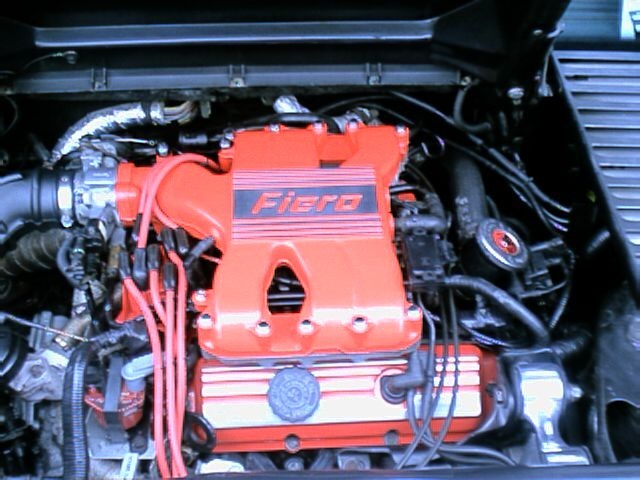

I found this stuff at Home Depot that worked real good. It's called Klean Strip Premium Stripper. It even came with a spray dispenser. Its sprayable. It works on paint, epoxy, and polyurethane. Do not let any of it get on any part of your body because it is caustic and burns like heck, even the paint flecks that are stripped off burn. All it took was a couple of applications to get all the paint off my manifold. Here's what it looked like after repainting. P.S. Use in a well ventilated area, it stinks.
